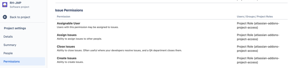

I am not seeing that option available. Could you possibly provide a screenshot?
JM Perrot
May 10, 2023
Go to the project settings in the left side bar, click on "Permissions" and you will see this permission :

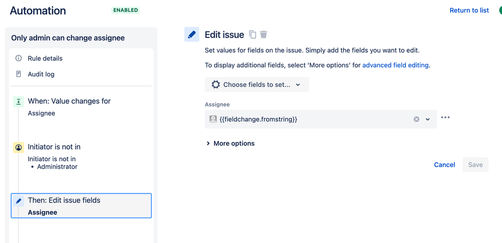

Ok in this case I think you can create an automation rule to avoid members to change the assignee :
The smart value {{fieldchange.fromstring}} restores the previous value.

Christina Evans
May 10, 2023
Perfect! Thank you so much! I have worked all morning on this and you responded and solved it right away.
