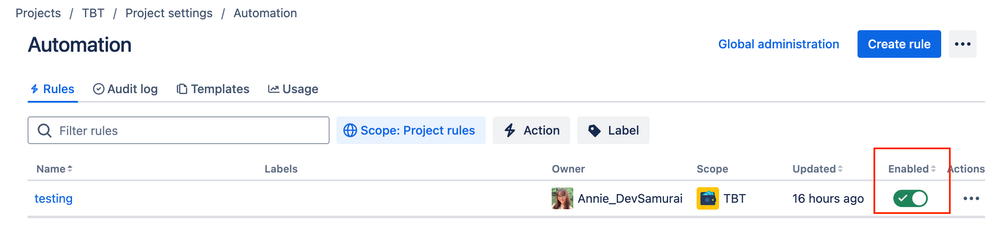

@Manar El Kefi have you enabled the rule yet?
You can go to Project settings > automation > then Click on the Enable button as the screenshot below
