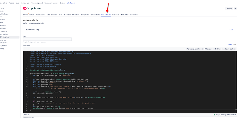

Below is the REST Endpoint code:-
import com.onresolve.scriptrunner.runner.rest.common.CustomEndpointDelegate
import groovy.json.JsonBuilder
import groovy.transform.BaseScript
import groovyx.net.http.HttpResponseDecorator
import groovyx.net.http.RESTClient
import javax.ws.rs.core.MultivaluedMap
import javax.ws.rs.core.Response
@BaseScript CustomEndpointDelegate delegate
getCurrentSprintDetails() { MultivaluedMap queryParams ->
def sprintId = queryParams.getFirst('sprintId')
def applicationProperties = ComponentAccessor.applicationProperties
final def baseUrl = applicationProperties.getString('jira.baseurl')
final def username = 'admin'
final def password = 'q'
final def headers = ['Authorization': "Basic ${"${username}:${password}".bytes.encodeBase64()}",
'X-ExperimentalApi': 'opt-in', 'Accept': 'application/json'] as Map
def http = new RESTClient(baseUrl)
http.setHeaders(headers)
def resp = http.get(path: "/rest/agile/1.0/sprint/${sprintId}") as HttpResponseDecorator
if (resp.status != 200) {
log.warn 'Commander did not respond with 200 for retrieving project list'
def sprintJson = resp.data as Map
Response.ok(new JsonBuilder(sprintJson['name']).toPrettyString()).build()
Below is a screenshot of the REST Endpoint configuration:-

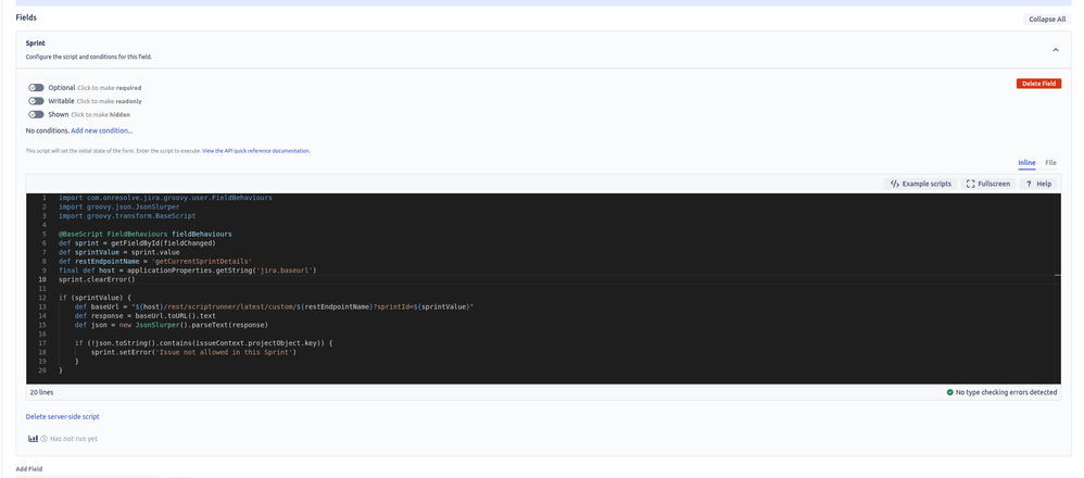

Below is the Server-Side Behaviour code:-
import com.onresolve.jira.groovy.user.FieldBehaviours
import groovy.json.JsonSlurper
@BaseScript FieldBehaviours fieldBehaviours
def sprint = getFieldById(fieldChanged)
def sprintValue = sprint.value
def restEndpointName = 'getCurrentSprintDetails'
final def host = applicationProperties.getString('jira.baseurl')
sprint.clearError()
if (sprintValue) {
def baseUrl = "${host}/rest/scriptrunner/latest/custom/${restEndpointName}?sprintId=${sprintValue}"
def response = baseUrl.toURL().text
def json = new JsonSlurper().parseText(response)
if (!json.toString().contains(issueContext.projectObject.key)) {
sprint.setError('Issue not allowed in this Sprint')
Below is a screenshot of the Server-Side Behaviour configuration:-
Please note that the sample working codes above are not 100% exact to your environment. Hence, you must make the required modifications.

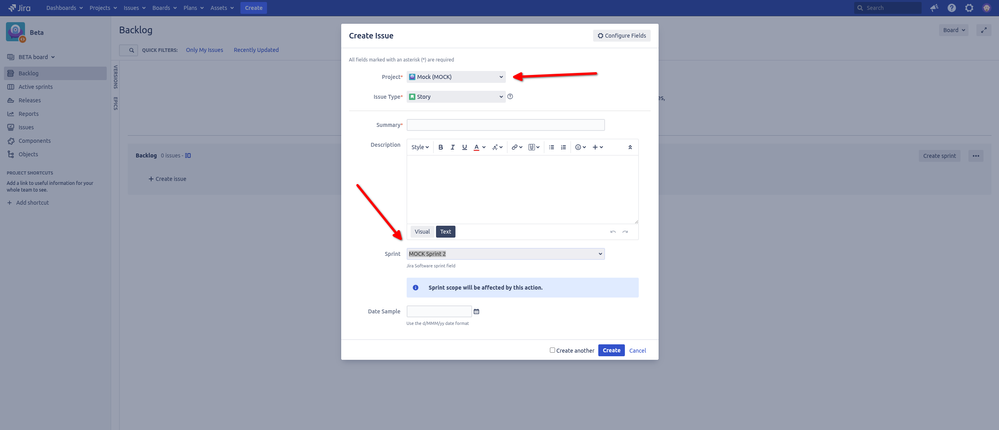

For the example code above, the Behaviour calls the REST Endpoint and checks to ensure that only Issues from the Mock project can be added to the Sprint.
Below are some test screenshots:-
1. For the first test, I try to create an issue from the Mock project and select the Sprint from the Mock project as well. As expected, the Sprint that is selected allowed for the Mock project.

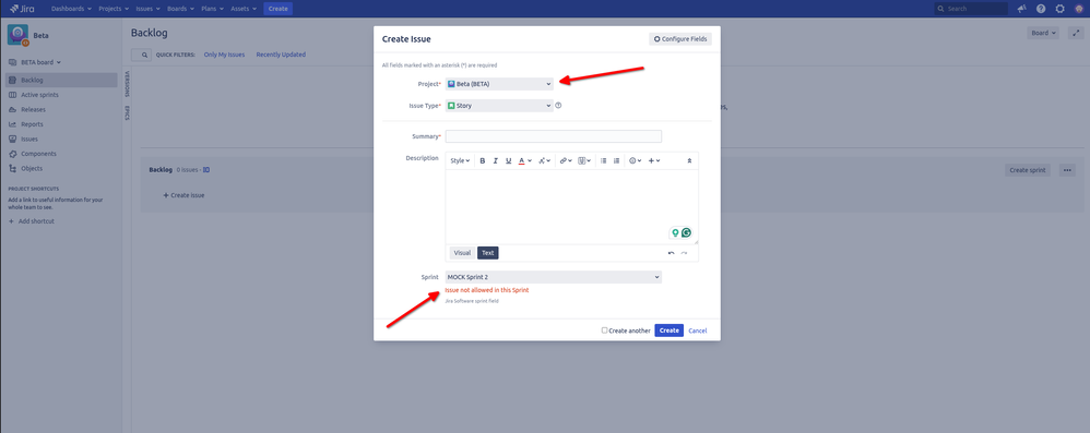

2. For the second test, I try to create an issue from the Beta project and select the same Sprint selected for the Mock project. As expected the Sprint is not allowed for the Beta project and a validation error message is returned as shown in the screenshot below:-
I hope this helps to solve your question. :)
