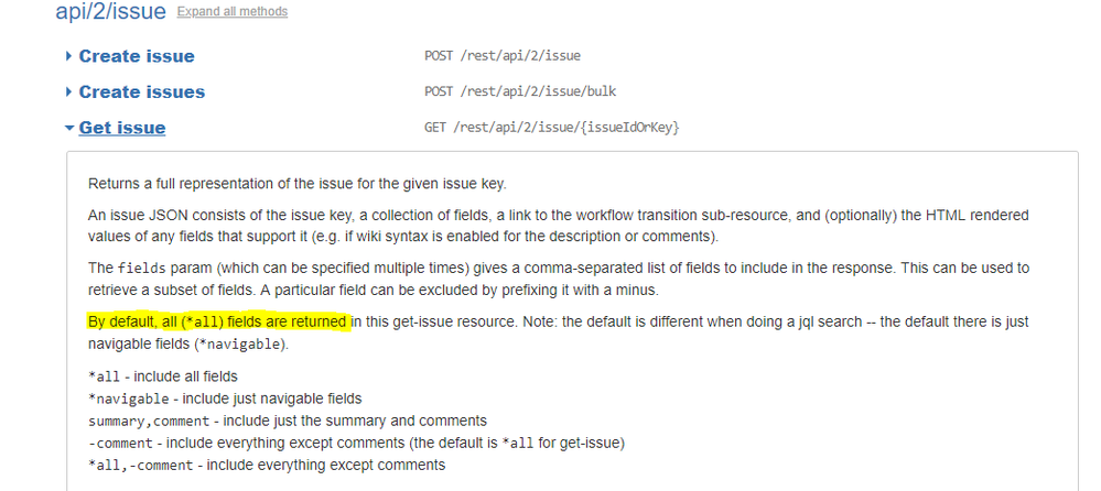

Hello Jivago,
You can try this: rest/api/2/issue/{issueIdOrKey}
But you have to create an issue first, i think is not possible to get all field by issuetype or project.
You can look at this page for more informations or examples: https://docs.atlassian.com/software/jira/docs/api/REST/7.6.1/?_ga=2.61178217.456026072.1536145241-408726963.1529654643#api/2/issue-getIssue
Sorry my english is not my native langage. Let me know if it's ok for you.
Hope it will help
