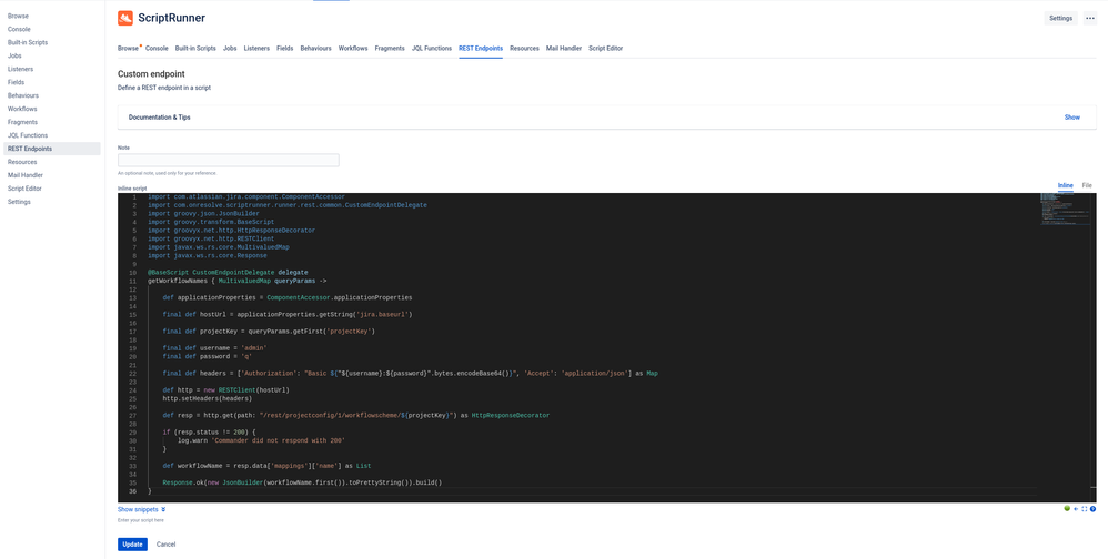

Below is a screenshot of the REST Endpoint configuration:-

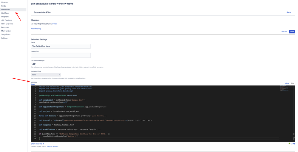

Below is a screenshot of the Behaviour configuration:-

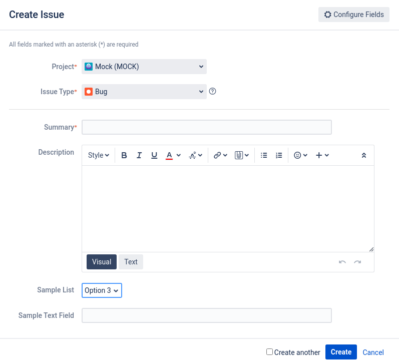

1) When the Behaviour starts, the Initialiser will invoke the REST Endpoint and specify the List value depending on the project workflow that is used. If the condition is true, the Sample List will set the value to Option 1, and the Sample Text Field will be visible.
2) If the List's option is updated to either Option 2 or Option 3, the Sample Text Field will still be visible.

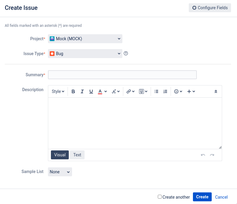

3) If the Sample List field is updated to either Option 4 or None, the Sample Text Field will be hidden, as shown in the screenshots below:-
