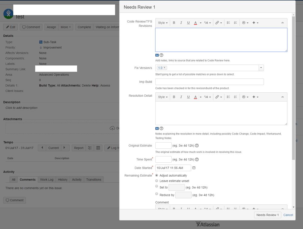

We created a custom screen for one of workflow transition ("Need Review") and regular issues and sub task share this screen. However, we noticed that when an issue is sub task, "Reviewer" filed is missing though all the rest of fields are there; However, if it's an regular issue, then the screen has all the fields.

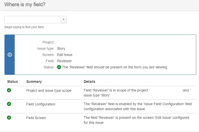

I checked the "Where is my field" configuration, seems the field "Reviewer" should be there, but it's missing

That's good, it shows 2 of the 3 points are set up right.  That means it should be down to the "Field Screen" on the last line.
The field might well be on the "Edit" screen for the issue, but is it on the "transition" screen for that transition?

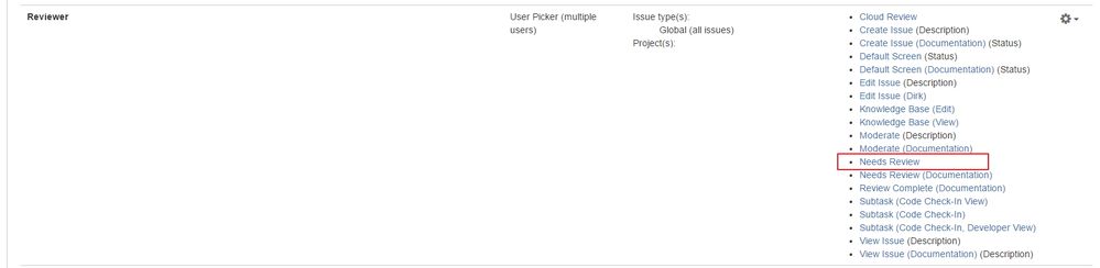

You mean this one? The red rectangular is the screen where it's missingImage 164.jpg
Nic Brough -Adaptavist-
July 10, 2017
I was looking for the "user picker (multi)" bit really, but that's fine, I was worried that it was some odd field type that might be hiding itself, but that's ruled out that!
The box you've got in red tells me that the screen "Needs Review" is not in use though.

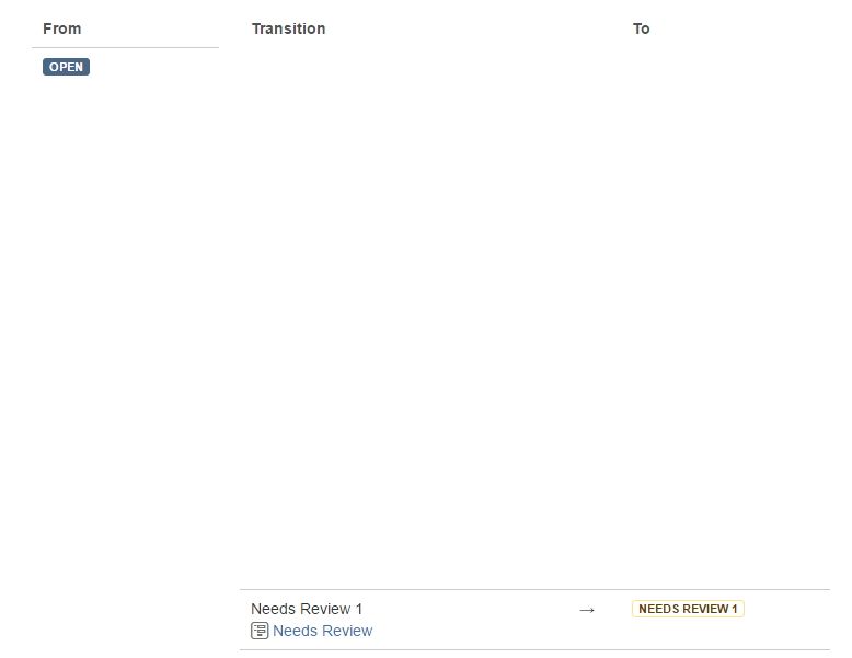

Sorry, but I don't understand "the screen "Needs Review" is not in use though." The screen is for one of transitions. It's in use. All the fields in the screen are there excpet "Reviewer". See the screenshot. actual screen.jpgfields.jpgworkflow.jpg

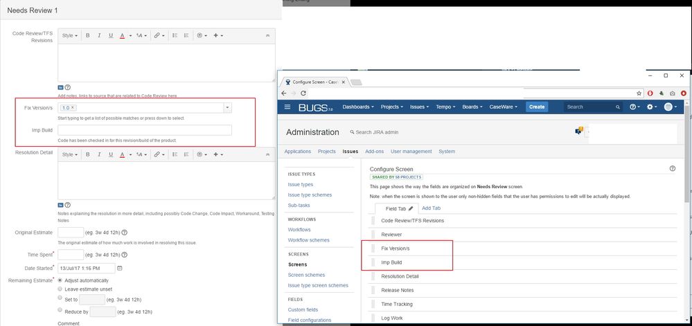

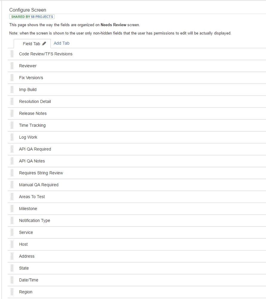

Hi Nic,
Sorry for this late reply. Got trainning entire day yesterday. I double checked our configuration and I'm pretty sure it's the screen we are using. See the screenshots below.
I switched the order between "Fix Version/s" and "Imp Build" in screen configuration and you can see the acutal screen got updated accordingly.
