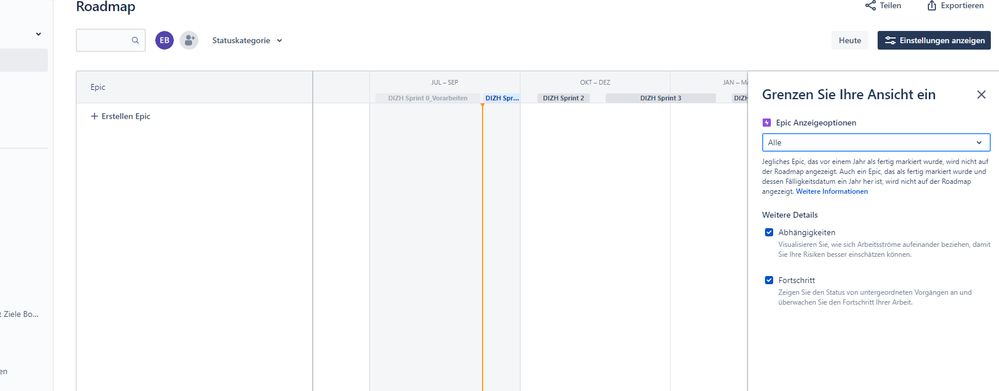

I checked the related entries in the forum on empy roadmap and I checked this FAQ https://community.atlassian.com/t5/Jira-Software-questions/Roadmap-Lost/qaq-p/1717693, but none of the solutions helped me fix the problem: I created and have worked with a roadmap for a while. I use a Scrum, not a Kanban board. I can see my epics as swimlanes in the board and as flags on the cards. So issue type epic and the epics exist. How to get my roadmap back??

Sorry, stupid mistake! Fixed it myself. The filter in the board settings was the problem (Board Settings / General and Filter / Filter / Edit Filter Query: Include epics in the board filter, save!). Roadmap is filled again :-)
