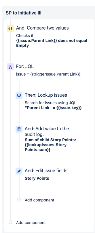

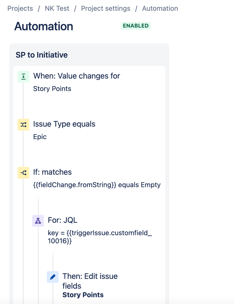

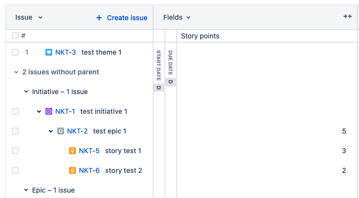

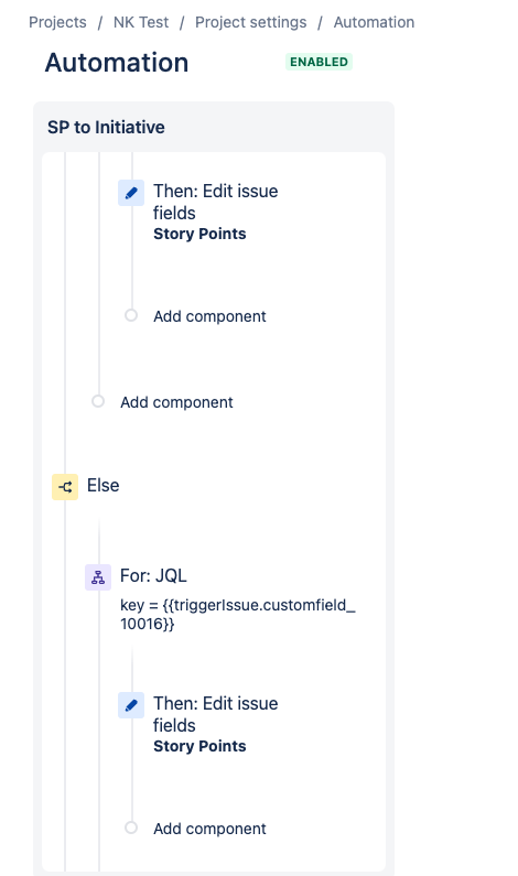

This is a snapshot of formula:
Here is a set up shows that Parent Link is not empty:

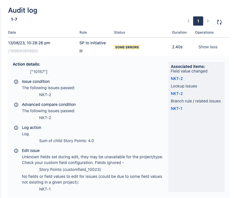

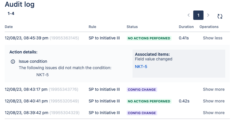

Audit log:
According to the log the rule was triggered for issue NKT-5, and that issue failed to meet the first condition - issue type = Epic. Therefore the rule did not proceed.
If the summaries shown for the issues in your other image are accurately noting the summary type, the NKT-5 is a Story type of issue. The only issue from that image that is both an Epic and has a Parent Link value is NKT-2.

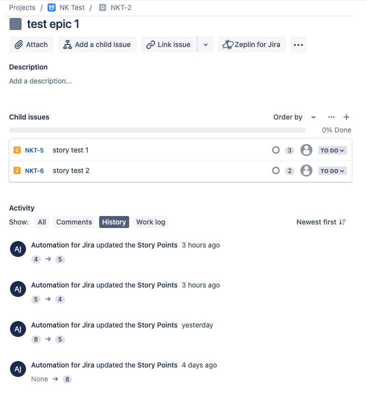

I changed story points for NKT-5, it is story.
And I also have automation for Epic sp summ up.
Changing the "Story Points" field for NKT-5, triggers rule for Epic and changes "Story Points" at Epic, NKT-2.
Which should trigger the rule for Initiative.
Is it correct?
Expectation is to have 5 story points for Initiative, because Epic received 5 story points (based on automation)

You're right, it shows "failed"
Unknown fields set during edit, they may be unavailable for the project/type. Check your custom field configuration. Fields ignored - Story Points (customfield_10023) No fields or field values to edit for issues (could be due to some field values not existing in a given project): NKT-1
May I kindly ask your advice here as well? Am I right to assume I need to change configuration for "Story points" field somewhere?

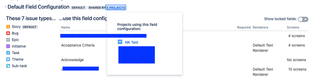

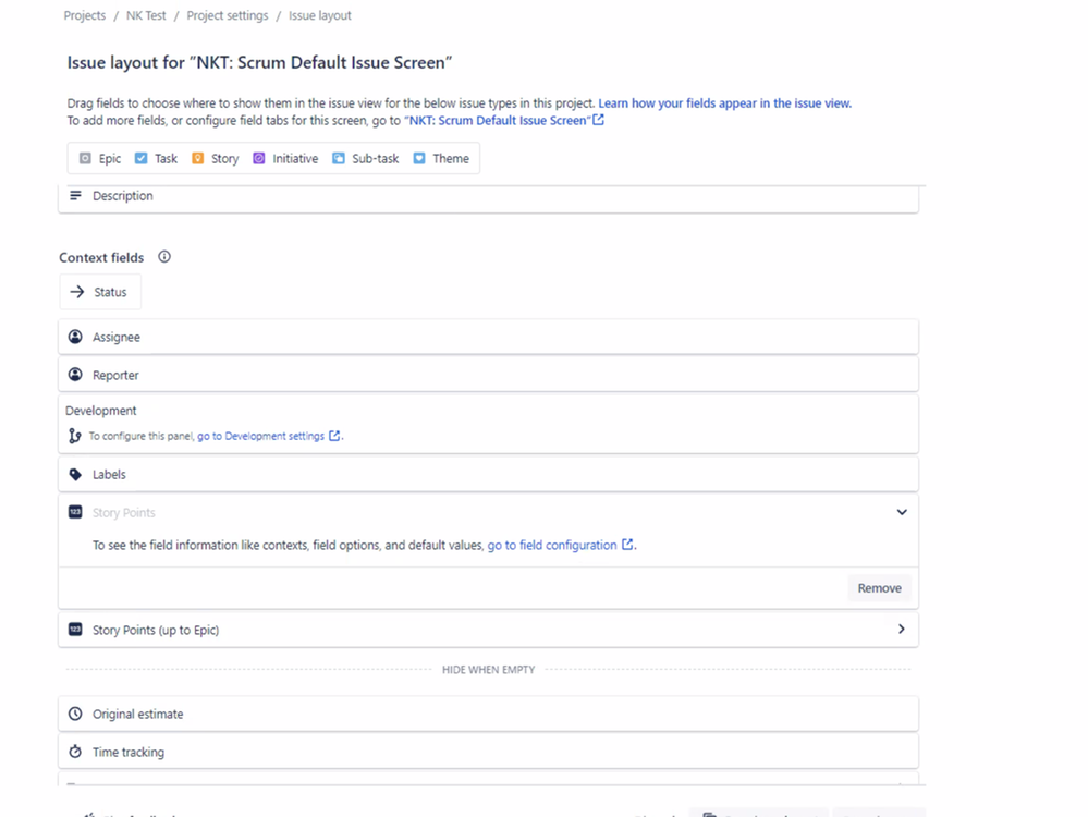

Do you have the Story points field in the Field Configuration and on the screens used for the Initiative issue type?
@Trudy Claspill
looks like everything is configured properly.
But ..maybe I missed smth?
1) Fields. "Story points" field is present

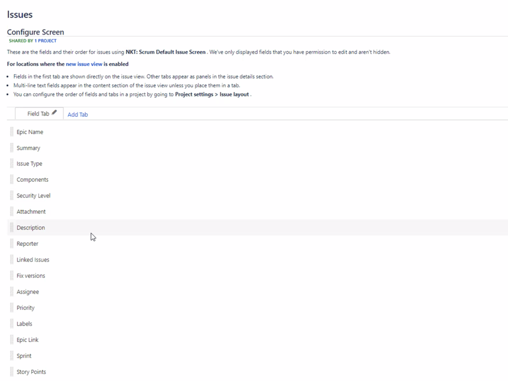

2. Screens.
Could you please advice how can I check the Screen configuration properly and make sure "Story points" is in place?

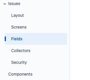

You can find Screen information under Project Settings > Issues > Screens.

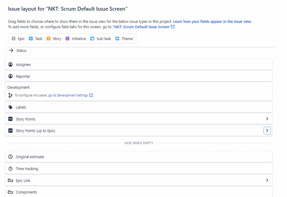

Also check for the field under Project Settings > Issues > Layout.

We checked all parameters, and it looks like we have "Story points" field activated everywhere.
But it still doesnt work.
What we missed?

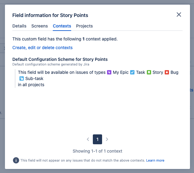

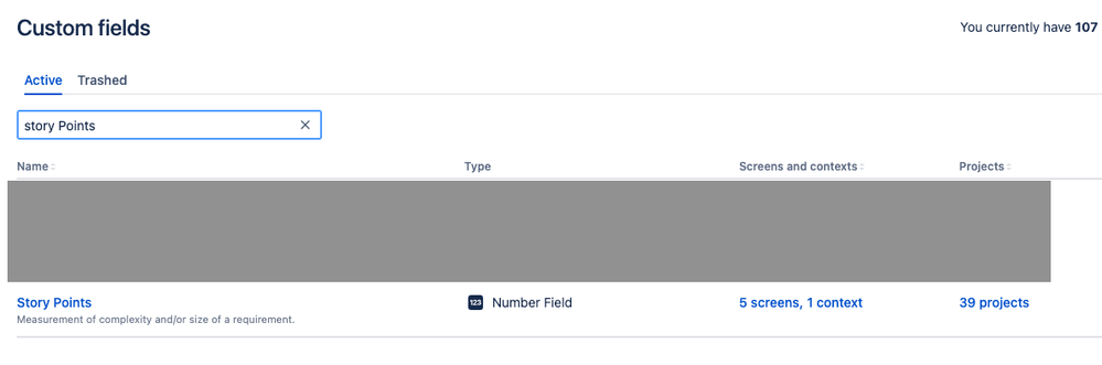

I missed mentioning another place to check. You will need to check the Context for the Story Points custom field. You can check that from Jira Settings > Issues > Custom Fields.
Search for the Story Points field and click on the # context link.
That will give you a screen similar to this.
You may see multiple configuration schemes listed there. Click the Create, edit or delete contexts link.
Check if the Initiative issue type has been included in the Story Points field context for the Default Configuration Scheme. If it has not you will need to edit the context configuration and add it.
Hey @Trudy Claspill
Thank you for advice, now its configured :)

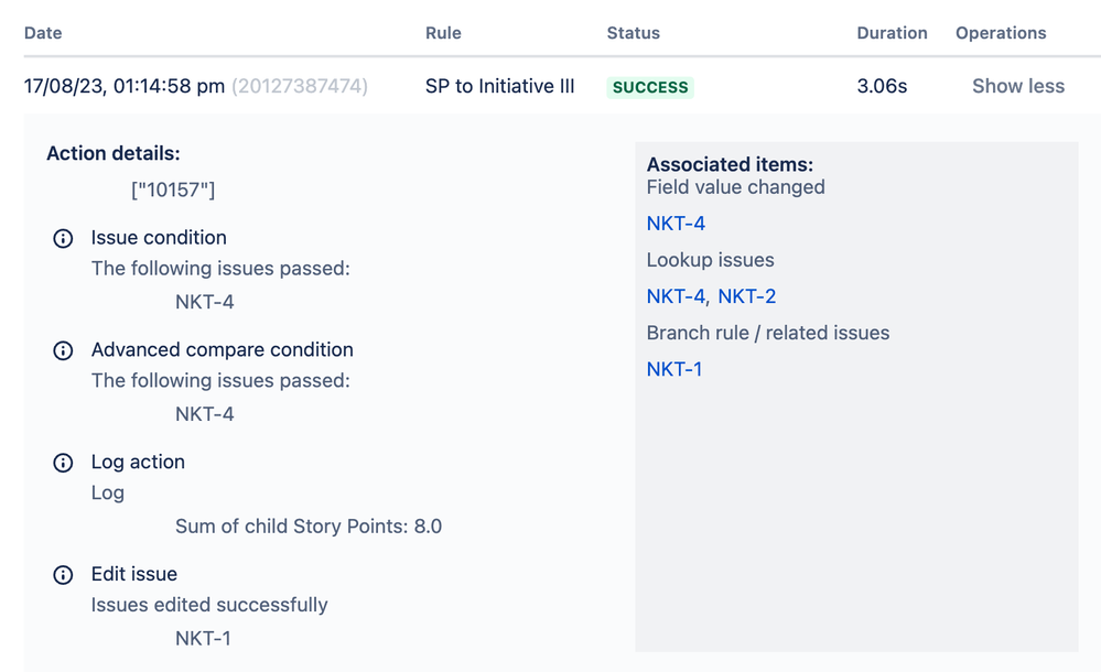

And formula is executing :)

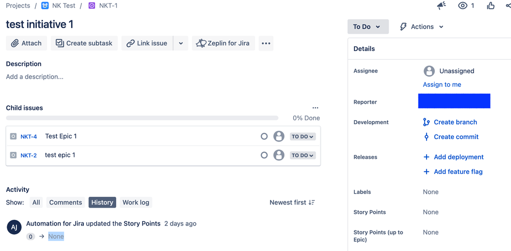

According to automation log field should be updated.
But for some reason it doesnt update the field with expected number. It updates it to "None"
Hello @Nataliya Krymska
I have set up the same rule in a test project, and it works for me.
Can you show us the details of the Edit Issue step, so I can check it for any potential typos?
Sometimes Automation Rules can get glitchy if they have been edited a lot. If there are no typos in the Edit Issue step, that I suggest that you try making the rule again from scratch? Disable this first version, make a new rule with the same steps and enable it, and then try changing the story points of the Epics. Let us know if the rule succeeds in updating the Initiative.
Hello @Trudy Claspill
Thank you very much for your advice - to check the "Edit" Issue step.
It was typo there. That is the reason why rule was executed, but field was updated with "None" :)
