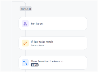

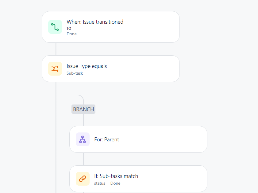

@Sameeksha Shetty You may have to use two automations to achieve this.
One for Transitioning Story based on Sub-Task and the other for transitioning Epic based on the Story.

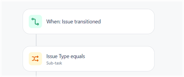

You may use the trigger - When issue transitioned
Check if the transitioned issue is Sub-task using an Issue Type condition
Add a branching for Parent and check if Sub-Task status match Done/Complete using a Related Issue condition.
And finally finally transition the Parent (story) to Done if above condition is true.
Similarly, you can do for Story-Epic status change.
Hope this helps.

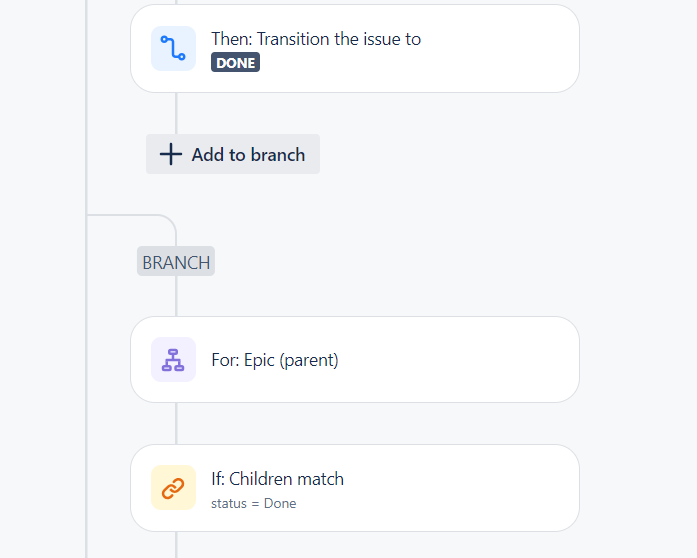

I've tried setting up this rule before but it doesn't seem to work for Epic-level issues It only updates the parent Story and shows a success message.

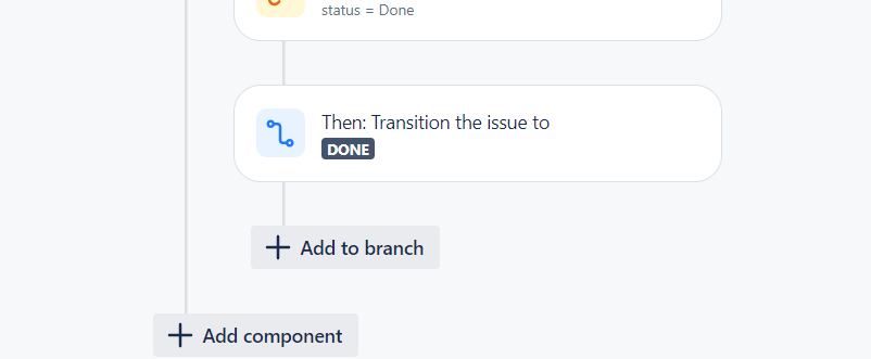

@Sameeksha Shetty This can be achieved.
Can you share the screenshots of your automations?
@Sameeksha Shetty I think you should spilt the automations into two. one for story transition and other one for EPic transition. it will work.
