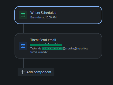

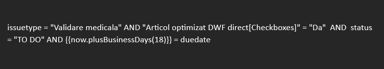

Here are the printscreens.
I want to check the issues of a certain type, with a checkbox field value of a certain type ("Da"), that have the due date in 18 business days and are still in status "TO DO". I am not receiving any email. All other conditions in this rule, except for the duedate one, are working fine for other similar rules.
Thank you for the additional information.
First swap the positions of duedate and the smart value so that the comparison has duedate on the left of the = and the smart value on the right.
Next, use a date/time format command to reduce the smart value to just a date:
{{now.plusBusinrssDays(18).jiraDate}}
Let us know if that resolved the errors.
Thank you so much, now it works! I have tried the "jiraDate" and putting the duedate before the smart value, but probably in different combinations than this exact one. Thank you again!
