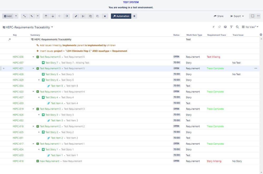

Your examples helped immensely. I have near zero knowledge of JIRA JQL and Structure so this helped me learn some new stuff. I made some minor modifications and ended up using two formulas. This gets be about 95% of the way to what I was looking for.
Here are the final formulas:
Requirement Trace
IF (issuetype="Requirement" and MATCH(JOIN#subtree#children{issuetype}, "*Story*") and MATCH(JOIN#subtree#leaves{issuetype}, "*Test*"); "{color:lime}Trace Complete{color}"; issuetype="Requirement" and !MATCH(JOIN#subtree#children{issuetype}, "*Story*"); "{color:red}Story missing{color}"; issuetype="Requirement" and !MATCH(JOIN#subtree#leaves{issuetype}, "*Test*"); "{color:red}Test missing{color}")
Trace Issue
IF (issuetype="Requirement" and !MATCH(JOIN#subtree#children{issuetype}, "*Story*"); "No Story"; issuetype="Story" and !MATCH(JOIN#subtree#leaves{issuetype}, "*Test*"); "No Test")
The lingering issue is for the Requirement Trace. In Test Requirement 5, the Requirement Trace returns "Trace Complete" since there is at least one story and one test. However, there is one Story that is missing a Test. This gets picked up by the Trace Issue column. Not a big deal, and like I said it gets me nearly to what I was looking for. Thanks again.

Mark Steudlein June 9, 2020
The first formula seems to work, but has an issue if the Requirement has multiple stories.
The second provides a similar (but cleaner) look. Same issue when a requirement has multiple stories. Also the Test Requirement 5 - Test Story 5 does not have a test case. How can I get this one to same Test Missing? Or would this formula only work on the requirement level?
