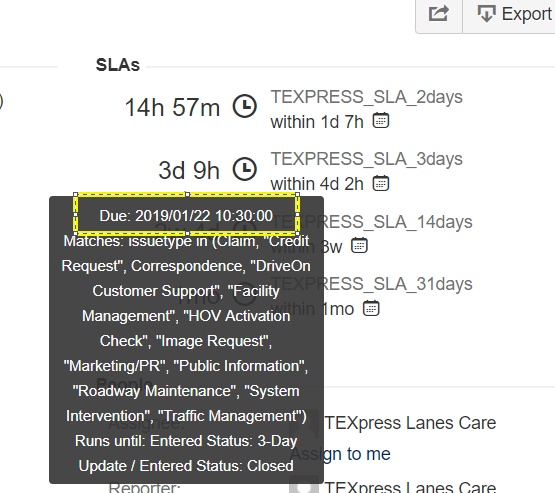

If we click on a running SLA, we can see the configuration of the SLA. And appears a Due Date, but can you explain us how it calculate this date?

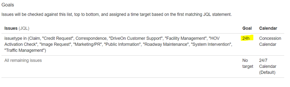

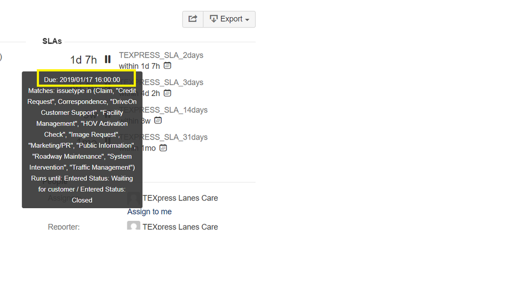

We have configured the goal at 24 working hours, it means 3 days. If the due date show matches with the goal the date would be 17/01 but shows 22/01/2017 .

With that said, I have never seen the due date as you show. maybe you are on server as I don't see this on cloud.

1. Create Date Time: TEXpress Lanes Care created issue - 2019/01/15 12:34:01 (At this time the SLA start running)
2. The Calendar is Monday to Thursday 8 working hours, starts at 8:30 am to 17:30pm. And Friday starts 8:30 am to 13:30 pm, 5 working hours.
3. Yes, the weekend is non working days.
4. The SLA has not stopped.
