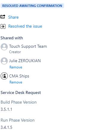

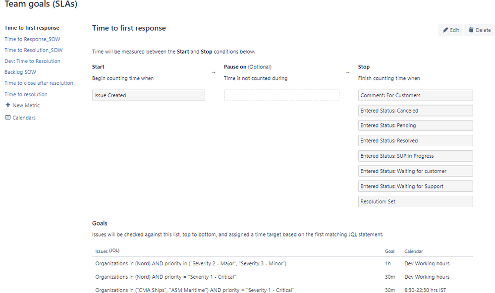

@Administrator Aim a bit confused here. Are you saying that your SLAs are actually showing on the Portal? To the best of my knowledge that isn’t possible. Of course cloud changes nightly so maybe I’m not there yet. I would like to see a screenshot of what you are seeing and, as Krister suggested, please provide a screenshot of your SLA goals/rules. I suspect some issues are following thru the rules resulting in no SLA but just a quest at this point.

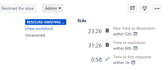

I guess my question remains whether you are seeing SLAs on the portal or not. The first image is from the portal and is what I would expect to see. The second is from the JSD application and is what I would expect. The third would tell me that if an issue is created that doesn't match any of your goals then there will be no SLA for those. Comparing your goals to the first image the Org matches CMA Ships but I'm unsure if priority is Severity 1 - Critical.

SLA is showing in the Agent's view, not in the Customer Portal.
And that is how it is designed to work. Unless something has changed SLAs are not displayed in the portal. If you have an example of that not being the case I would be interested in seeing it so my understanding can be updated.

You need to clarify your issue, post the SLA rules you have issues with, post whats different about the issues that do not get an sla or something more for us to be able to assist you.
If SLA is not showing that usually means that either a limitation exist tor it not to have SLAs or that the rules for posting it is not followed.
So start by going to your project settings > SLA and post the rules of whatever you have issue with.
