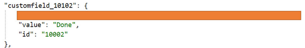

So I figured out what was going on. I pulled this issue via the API to look at the metadata and I learned that there is a field, and I bet this is the case for all the others that are having this same problem, called customfield_10102 which is actually, "Epic Status".
All I'm saying is, come on Atlassian, why do you even have to separate status fields for only one issue, just get rid of Epic Status...
Anyways, the temporary way to fix this is to turn on that screen and then change the value to something other than, "Done". The permanent fix for this is to modify your Epic Workflow to update the, "Epic Status" when your issue transitions through the workflow just like you have to do for resolution.

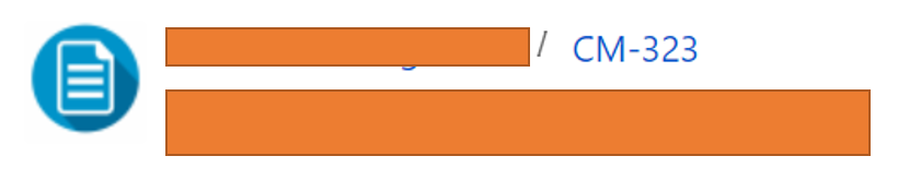

Here is the issueKey:
issueKey.pngHere is where the Epic should be showing up:
