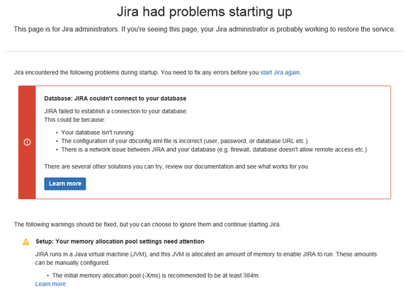

But when I wanted to restart JIRA I just got the following error.
So I followed the instructions and suggestions and checked the database.
This has also been restarted, reset the password and is fully functional.
With other programs, I can connect to the database, so I rule out this problem before.
Then I checked the configuration.
I edited the config.xml via config.bat.
Both the user, password and the database URL correspond to the original information. For safety's sake, I even consulted the old settings. They are identical except for a different spelling.

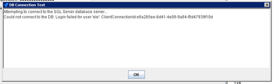

But I always get the following error when trying to connect:

What version of MS SQL is your database?   I ask because this newer version of Jira does not support the 2008 version of MS SQL any more.  Please see the Supported platforms documentation.  For MS SQL databases, this version of Jira has to use a 2012, 2014, or 2016 version.
In Jira 7.5 and higher versions, the database driver for MS SQL type databases has changed from the jtds dirver to use the microsoft database driver instead.   While you're driver-class tag looks ok, I think your URL tag specified for the database looks incorrect to me.
Please see the example in the Connecting Jira to SQL server 2012.  The sample dbconfig.xml file there will have a syntax like this:
  <url>jdbc:sqlserver://dbserver:1433;databaseName=jiradb</url>
  <driver-class>com.microsoft.sqlserver.jdbc.SQLServerDriver</driver-class>

Thank you very much. That seemed to be our problem. :)
