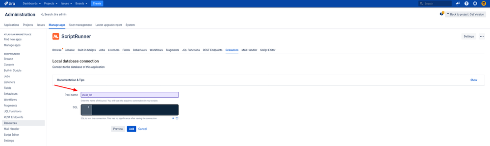

To answer your question, yes,  you will first need to set up a connection to your Local Database, i.e. the database your Jira instance is connected to using ScriptRunner's Resources.
Looking at the configuration print screen that you have shared in your previous comment, it appears that you have already configured it. And, have you saved the Local Database configuration?

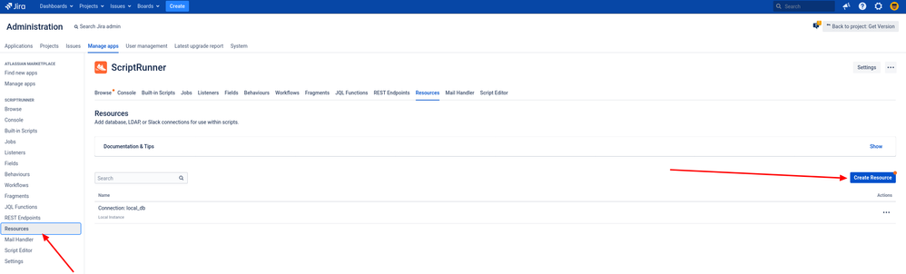

First, go to ScriptRunner's Resources and setup and Local Database connection as shown below:-
Once you have selected Create Resources, select Local Database connection as shown below:-
Next, enter the name you want to use for the Local Database connection and save it.
In the print screen above, the Local Database name set is local_db. This is the same name that is used in the DatabaseUtil.withSql shown in the sample code below.
Using the DatabaseUtil, you do not need to use the ConnectionFactory as shown in the Sample Code below:-

@Ram Kumar Aravindakshan _Adaptavist_  Intially i was trying without creating connection with the local database. I was simply trying to run script in script console.
Now i have created local database connection having name local_db and SQL box is empty. Now i am trying to run below query :-
it's giving me only single value, i need complete list of fields. I have tried to change sql.rows to sql.eachRow but not working. Kindly suggest.
