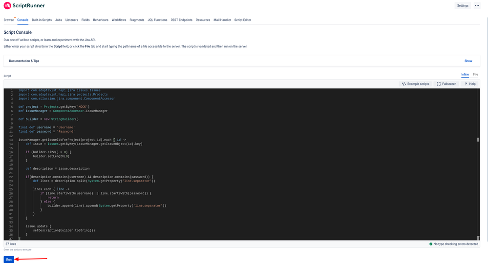

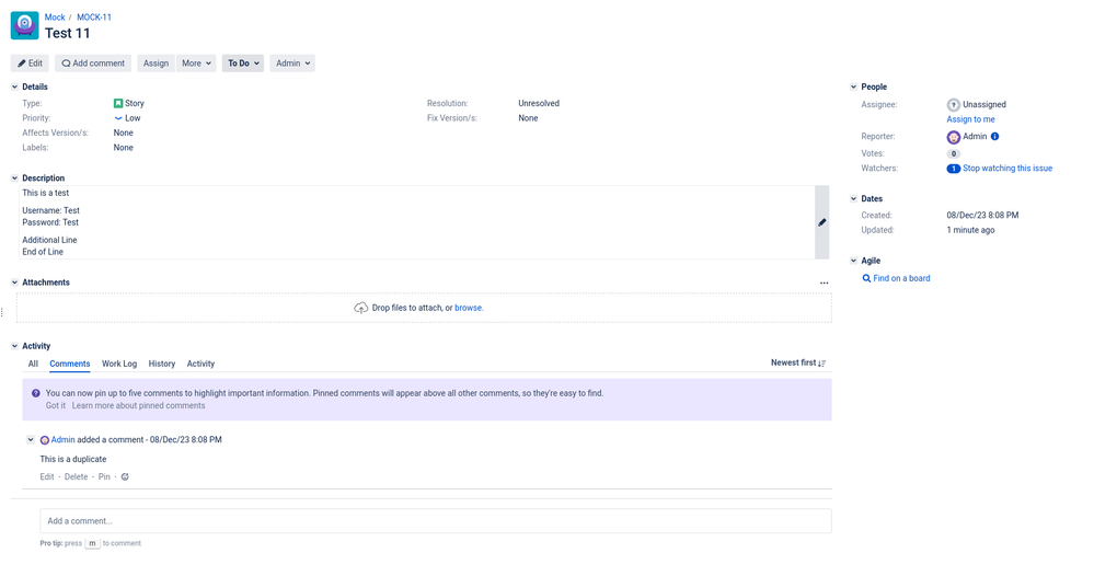

Below is a screenshot of the ScriptRunner Console configuration:-

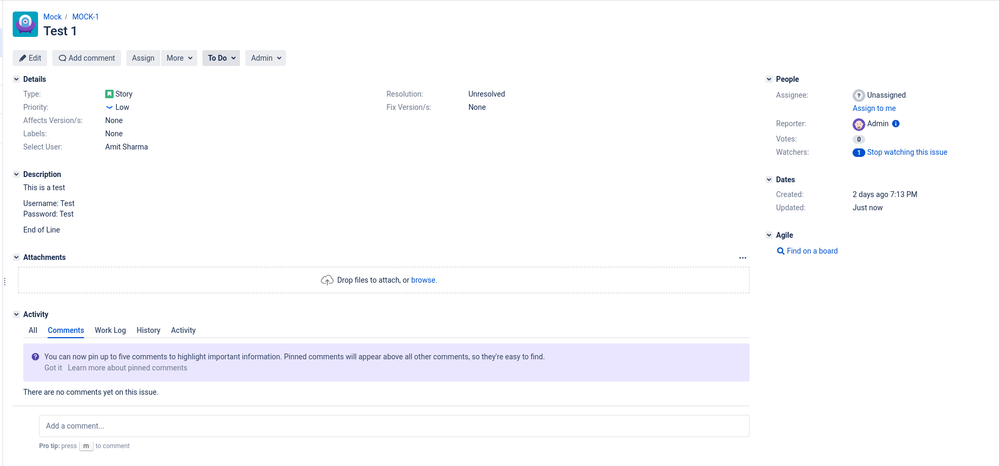

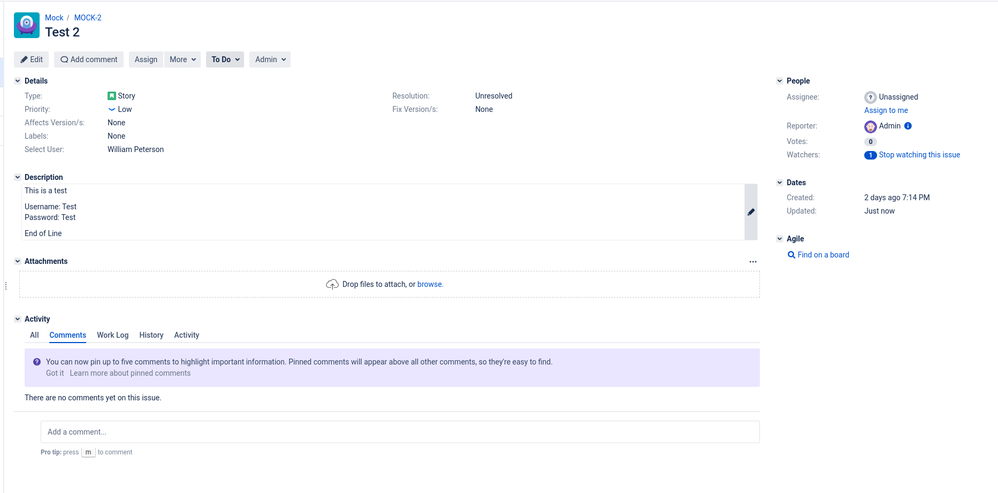

Below are a couple of test screenshots for your reference:-

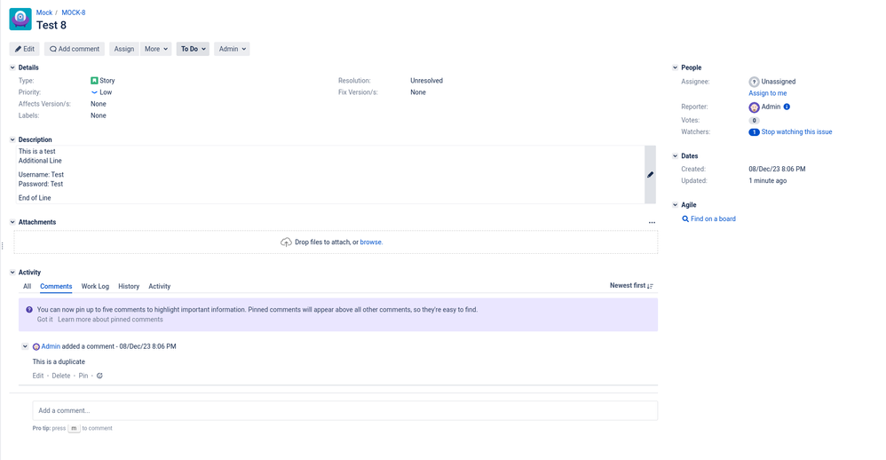

1. The screenshots below display all the issues where their description contains the username and password values before the script has been executed.

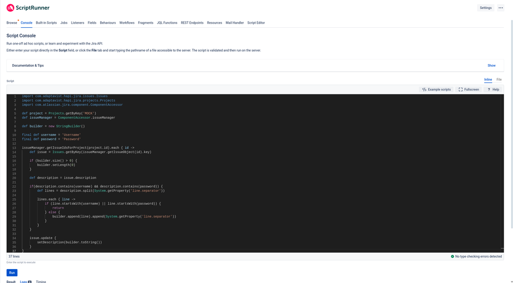

2. Next, in this screenshot I am executing the script

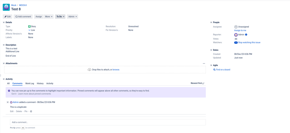

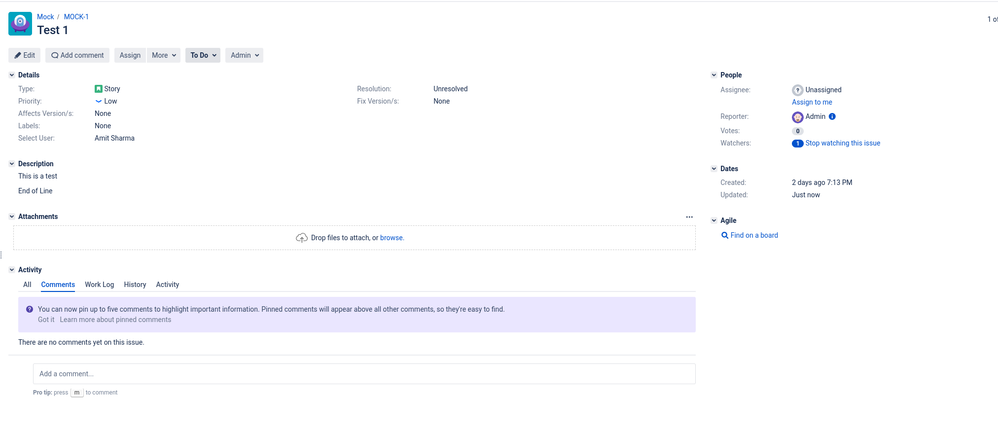

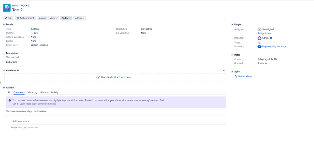

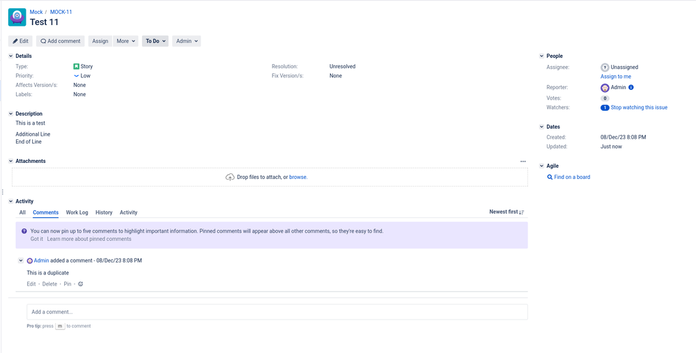

3. Finally, in the next screenshots, you can see that the usernames and passwords have been removed from the issue descriptions.
