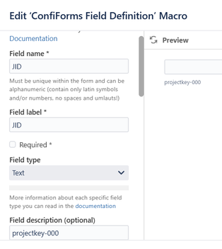

I have a Confiform conundrum I'm hoping you can help me with. We have a form that creates a JIRA issue and stores that result in the variable JIRAID. We can pass that result to an IFTTT generated email using $iftttResult_JIRAID, but we also want to set a variable value so the result is passed to the Confiform table. When we use the Confiform Rules for Form Field macro to set the variable JID=$iftttResult_JIRAID it doesn't pass the actual result just the text $iftttResult_JIRAID.
IFTTT Event *onCreated
Choose Action to perform *Create JIRA Issue
Set custom name for this action result (alphanumeric, no spaces) *JIRAID
We've tried changing the type of field JID is (Text vs JIRA Issue) as well as changing the location of the rule that sets JID to the JIRAID result (inside the IFTTT vs just after the IFTTT) but nothing seems to work.

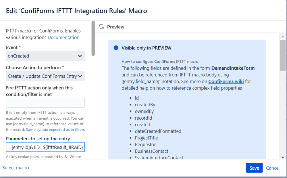

You need to store the result of this IFTTT, by adding another ConfiForms IFTTT macro (after the one which creates Jira issue) with action to "create/update ConfiForms entry" and parameters set to
entryId=[entry.id]&JID=${iftttResult_JIRAID}
So, the result of the "Create Jira" action will be stored back to the record (in a form)

I was able to save the key into a text field then use another IFTTT macro to pull the text and set the key to the "jira issue" field.
There is no need to have a second IFTTT... just save the returned key into the ConfiForms Field of "Jira issue" type and use it to access any property of Jira issue directly

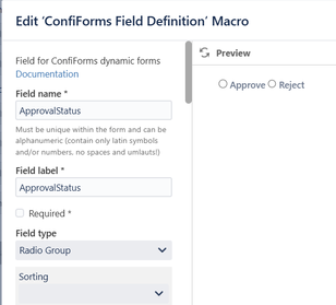

I have field approval status. Once approved and submit the form then Create Jira issue and save jira issue key store back into confiform.
But we are able to create "Jira issue" but could not store back Jirakey into confiform field.
but could not get Jira issue. Kindly help what i done wrong

So you have your IFTTT rule to create an issue in Jira to be executed onModified and only when the field "ApprovalStatus" has certain value, but you configured an IFTTT that should take the result of it to be executed onCreated!?
Well, if you want to use the result of that IFTTT then of course you need to run it with the same condition/event and place it after the IFTTT that produces the result
Do you have this IFTTT configured AFTER the one that creates the Jira issue?
Does you Jira issue creating IFTTT has a result name set to JIRAID?
May be this simple video will help (although I have tried to answer you earlier multiple times with links to tutorials and videos... kind of a last resort... but I will try - https://wiki.vertuna.com/download/attachments/178782502/Community%20-%20create%20Jira%20issue%20and%20save%20back%20created%20Jira%20issue%20key.mov?version=1&modificationDate=1736681997180&api=v2)
And how do you set the result from the IFTTT that creates a Jira issue? Looks like you set a value with a dollar sign or something
Yes You are right! Now its working properly.
