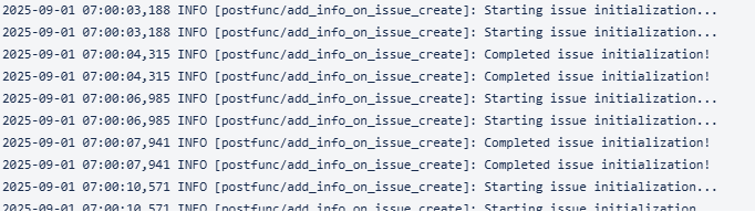

Hi everyone, I found out that logs in Script Editor have duplicated records.
So logs look like that for every record:
2025-09-01 16:16:39,012 WARN [Project.ScriptName]: record name
The same problem occurs for every script located in Script Editor.
On the other hand if I run script via Script Console, I don't have this issue.
Is there any way to fix it? Unfortunately I could not find the solution on my own.

Hi @Stefan Salzl
I found this issue at postfunctions and jobs. And it is definitely reproduced for several scripts, so there's no dependency between scripts and so on.
How does it look for job log:

So I found this issue at two different post-function script written by me, both are located between "Add a comment to an issue if one is entered during a transition" and "Update change history for an issue and store the issue in the database" options, Also same bug was found at one of Jobs.
I dont have any scripted fields, First postfunction updates Assets field value and second one assigns an issue to specific user if some conditions passed.
So it is reproduced for quite different cases.
To be honest I don't know how logs could be helpful in this case, nothing changed, any log is recorded twice, please take a look at one more example
2025-09-02 10:03:41,564 WARN [Project.DataToSet]: It's a wrong group, stop
And yes, I use custom logger and it worked perfectly couple if weeks ago
