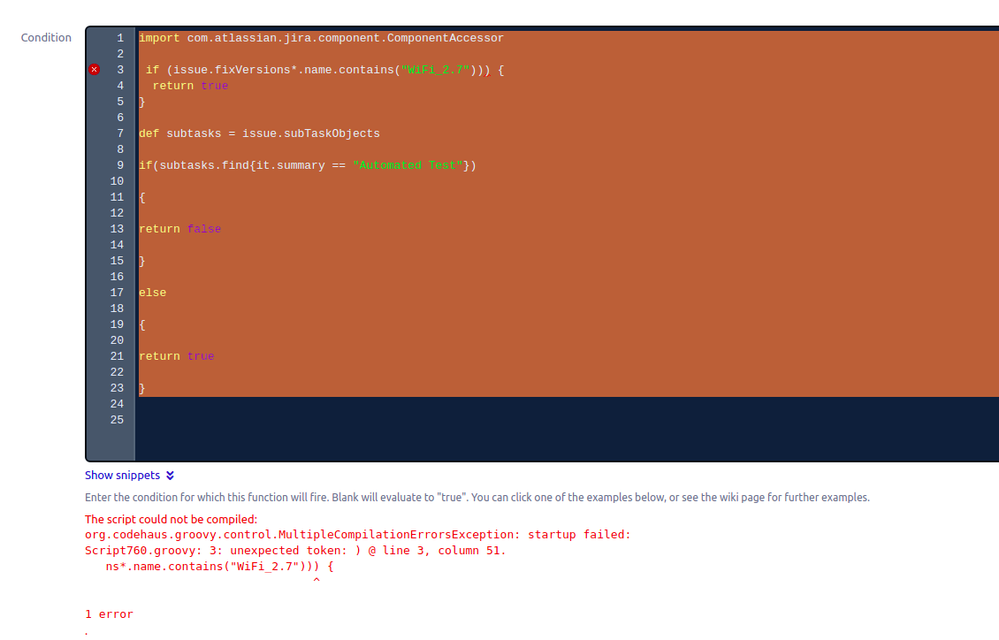

Hi @Tuncay Senturk
Thank you very much for your reply. I tried your script but it throws the error  you can see the script below
if (issue.fixVersions*.name.contains("WiFi_2.7"))) {
return true
def subtasks = issue.subTaskObjects
if(subtasks.find{it.summary == "Automated Test"})
return false
else
return true
And the error logs are
The script could not be compiled:
org.codehaus.groovy.control.MultipleCompilationErrorsException: startup failed:
Script760.groovy: 3: unexpected token: ) @ line 3, column 51.
1 error
erroe log.png Please let me know how to achieve this
Tuncay Senturk
September 2, 2021
I am sorry there were too many closing braces.
Please try this one,
if (issue.fixVersions*.name.contains("2.5.4")) {
return true
I also corrected the above answer.
