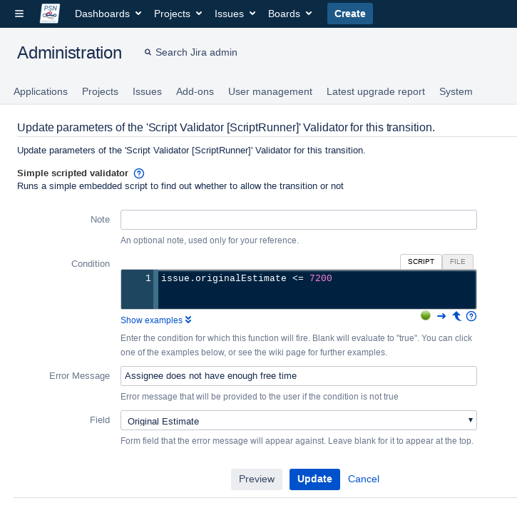

×I've created a simple validation script (for this test) which stops an issue/record transition if the original-estimate (time tracking fields) value is greater than 2 hours. It's implemented as a Validator on my custom Workflow and is coded as:
issue.originalEstimate <= 7200
Problem 1, I set the associated Script Validator Field as Original Estimate and make the User confirm the Estimate via a Transition Screen. Upon click the associated button the validation fires and when the condition above returns false nothing occurs on the UI but the atlassian-jira.log captures a series of errors (shown below). Entering a valid estimate (<2hrs) seems the transition complete as expected. Note, if I leave the Script Validator Field set to <blank> the expected functionality works, i.e. either an error message is displayed or the transitions occurs when correct. Any ideas?
Problem 2, I'd like this validation to not reply on a transition screen but when no screen is specified the error message I added is displayed in a dialog but also a message about "an illegal workflow operation" and "contacting the Jira admin" (see below) How do I get rid of these messages. Note, this dialog/validation also only works when the Script Validator Field is set to <Blank>

That's correct - similar to the 'Fix Version' example
In terms of 'screen' I have tried a Transition screen and also the Create screen.
N.B. The 'Original Estimate' field is part of the 'Time Tracking' field.
I think the problem is the Field setting on the dialog provided - if I leave that blank it seems to work on both screen scenarios.
Hi Garry,
Let me get this straight.
1. You have a transition screen with 'Original Estimate' field on it.
2. You have a scripted validator on this transition which checks if the value entered in 'Original Estimate' is less than 2 hours and if it isn't you want an error message displayed on screen?
