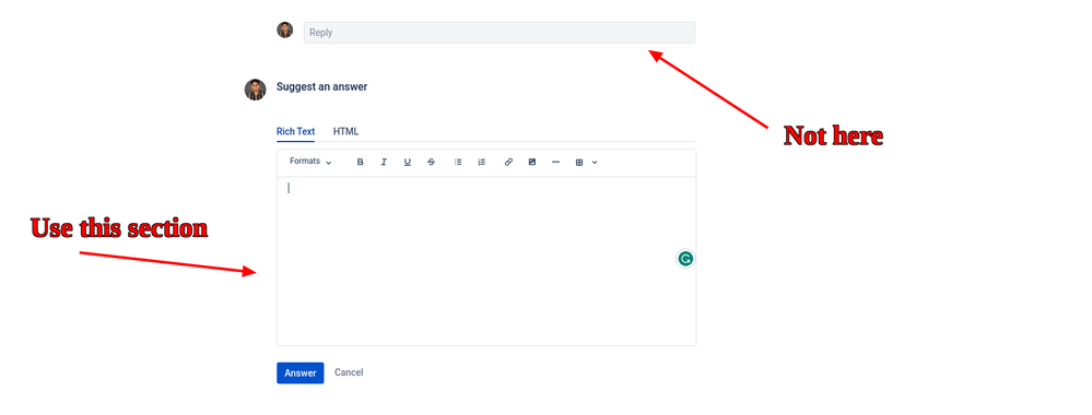

You only have to use the Suggest an Answer field once, i.e. the first time. :-)
All subsequent answers you can provide in the Reply field.

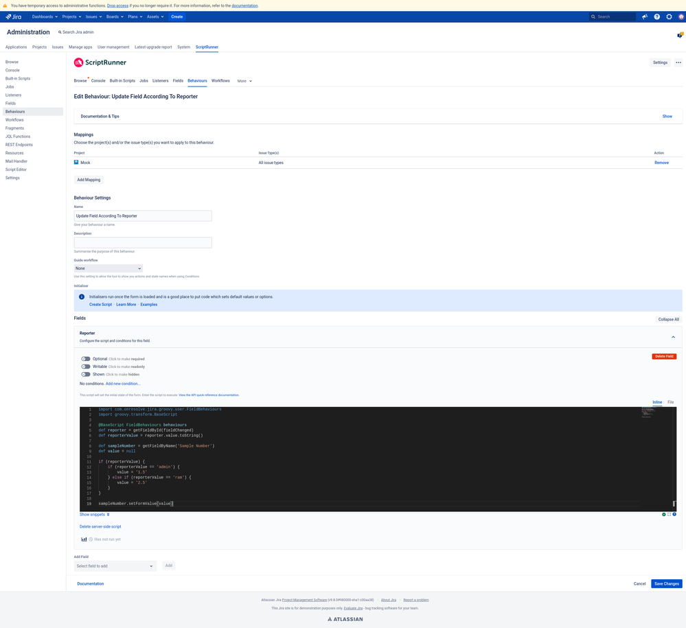

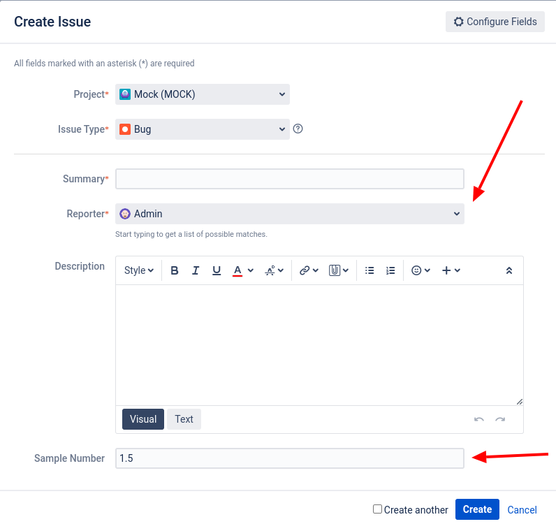

Below is a screenshot of the Server-Side Behaviour configuration:-

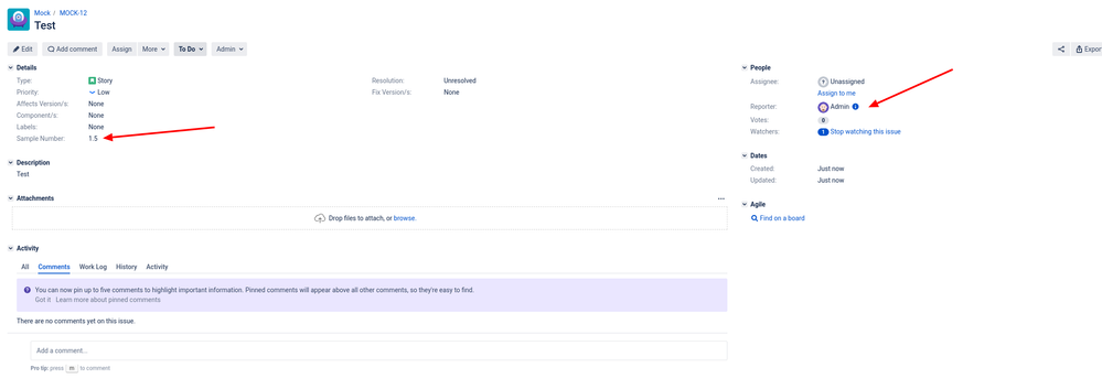

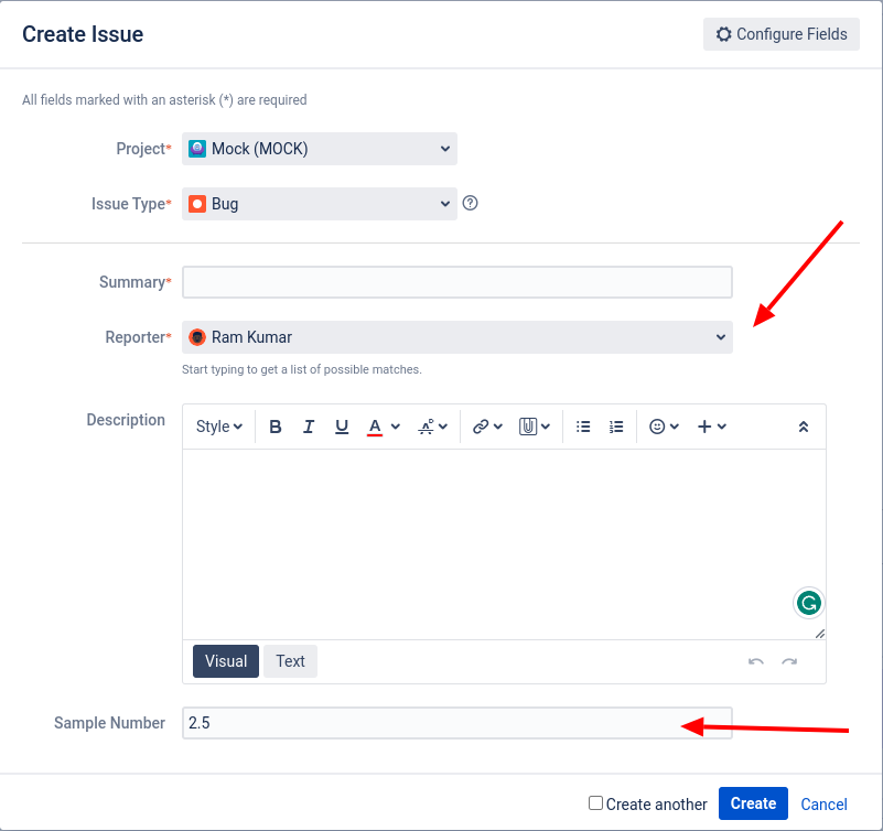

I am also including a couple of test screenshots for your reference:-
1. When a new issue is created, if the user Reporter is set to the user Admin (username is admin), the Sample Number screen is set to the value 1.5.
2. If the user is changed to Ram Kumar (username is ram), as expected, the Sample Number field is updated once again, and the value is changed to 2.5 as shown in the screenshot below:-

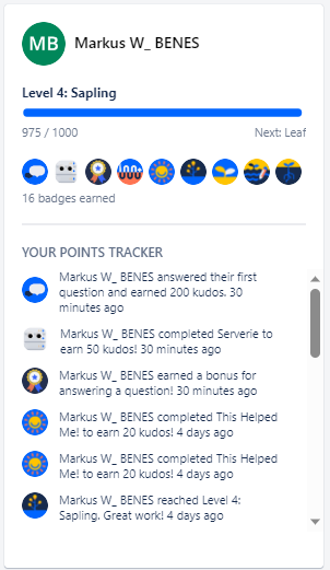

@Ram Kumar Aravindakshan _Adaptavist_ after i clicked answer was already here; after some seconds it was away again and your answer was there... looked for me like it got deleted...
my answer was definitely successfully posted because i got 200 kudos and two bageds for it.
@Ram Kumar Aravindakshan _Adaptavist_ if my answer really got not deleted it must have been a bug... here is the screenshot of my badges.

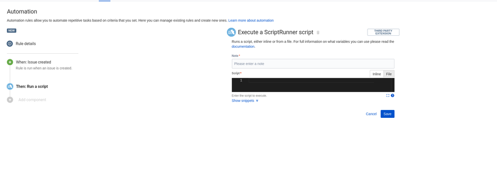

Thank you for getting back and providing your clarification.
Could you please provide me with a screenshot of the Automation plan you are using so I can try to test it in my environment and provide a solution?
I am looking forward to your feedback.

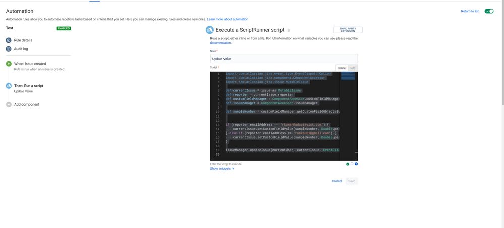

I've made an attempt to integrate your code into an automation rule, but as of now, the functionality remains elusive. The encountered error message reads as follows:
Execute a ScriptRunner script action for Automation for Jira
Script function failed on Automation for Jira rule:
Script function failed on Automation for Jira rule: Hourly Value, file: <inline script>, error: java.lang.ClassCastException: class java.lang.String cannot be cast to class java.lang.Double (java.lang.String and java.lang.Double are in module java.base of loader 'bootstrap')
Given this obstacle, I am receptive to exploring alternative suggestions you might offer to address this issue.
I extend my gratitude for your forthcoming assistance.
Best regards,
Humberto
this is what I have now...
Trigger: Issue created.
Action:Run Script Runner
Code:

In your previous comment, you mentioned:-
I appreciate your proposed script, acknowledging that it's a community contribution. One initial question arises: why are we using "arrays" in our solution? I apologize for seeking clarification on this matter. Is there a possibility that we're inadvertently overcomplicating the solution?
My perspective was a more direct and simplified code approach. However, I am relying on your expertise and generosity to guide me through this process.
The example codes that I have provided are meant for ScriptRunner's Behaviour. It will not work with Automation.
This is why I have asked you for a screenshot of your automation config for example:-
This is so I can try to test it in my environment and provide a better solution for your requirement.

If you are using Automation, all you have to do for Issue Created / Issue Update is this:-
import com.atlassian.jira.event.type.EventDispatchOption
import com.atlassian.jira.issue.MutableIssue
def currentIssue = issue as MutableIssue
def reporter = currentIssue.reporter
def customFieldManager = ComponentAccessor.customFieldManager
def issueManager = ComponentAccessor.issueManager
def sampleNumber = customFieldManager.getCustomFieldObjectsByName('Sample Number').first()
if (reporter.emailAddress == 'user1@mail.com') {
currentIssue.setCustomFieldValue(sampleNumber, Double.parseDouble('1.5'))
} else if (reporter.emailAddress == 'user2@mail.com') {
currentIssue.setCustomFieldValue(sampleNumber, Double.parseDouble('2.5'))
issueManager.updateIssue(currentUser, currentIssue, EventDispatchOption.DO_NOT_DISPATCH, false)
Below is a screenshot of the Automation configuration:-
I have tested this code, and it is working in my environment.
Below is a test screenshot for your reference:-
I hope this helps to solve your question. :-)
Thank you and Kind regards,
Ram
