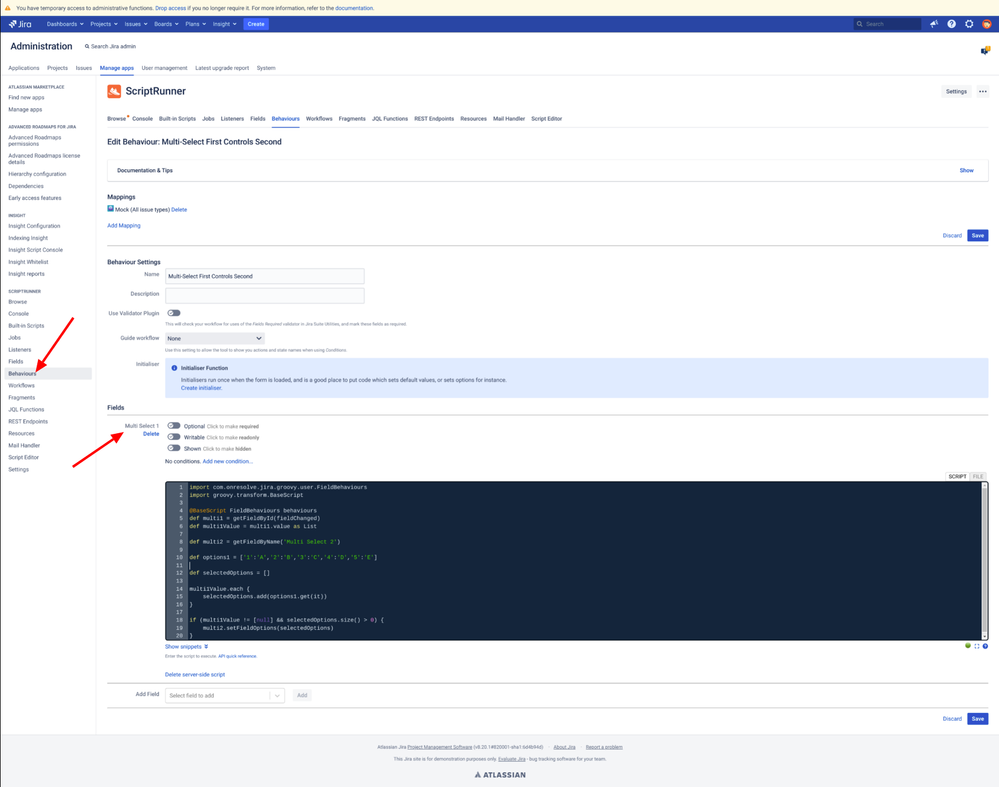

Below is a print screen of the Behaviour configuration for your reference:-

In this example, I use two Multi-Select fields, i.e. Multi Select 1 and Multi Select 2. The Server-Side Behaviour has been configured for the Multi Select 1 field.
Hence, when the options are selected in the Multi Select 1 field, the options will be filtered accordingly in the Multi Select 2 field.

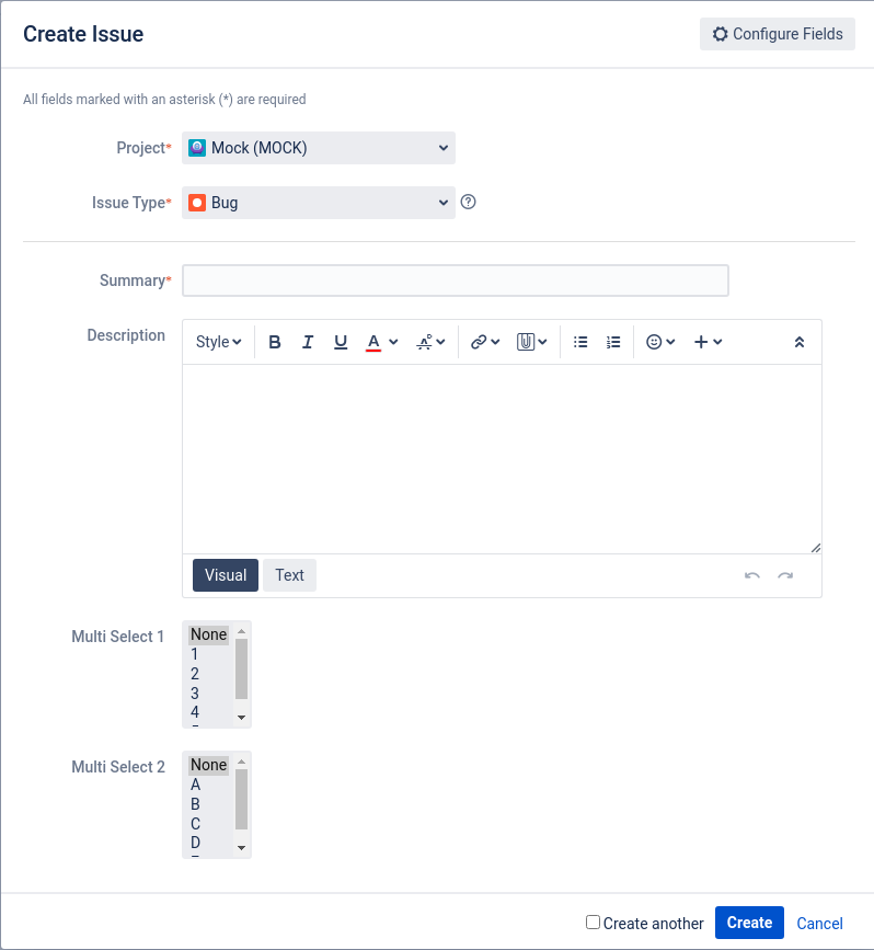

1. When the issue is being created, and no selection is made from the first Multi-Select field, all the options in the second Multi-Select field are also visible as shown in the image below:-

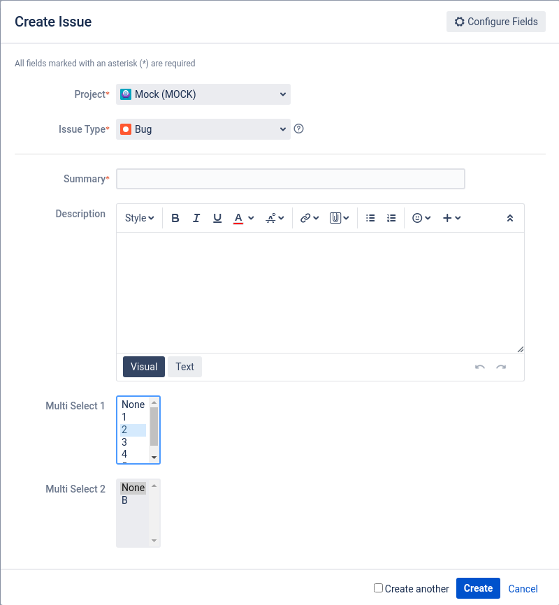

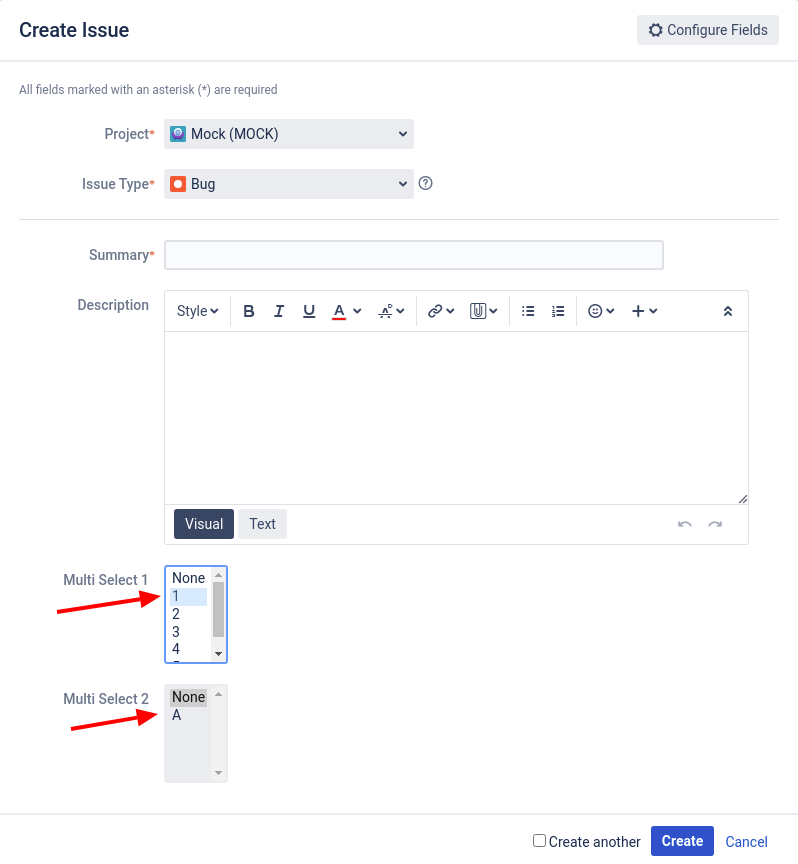

2. Once the options are selected in the Multi Select 1 field, the options in the Multi Select 2 field will be filtered accordingly, as shown in the images below:-
