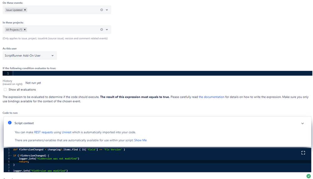

You can create Listener, set event to Issue Updated, leave condition empty (it evaluates jira expression which can be not sufficient here), and write the following in Code section:
def fixVersionChanged = changelog?.items.find { it['field'] == 'Fix Version' }
if (!fixVersionChanged) {
logger.info("fixVersion was not modified")
return;
logger.info("fixVErsion was modified")
The script checks the changlog to find out which issue element has been updated. This changlog can look somehing like this:

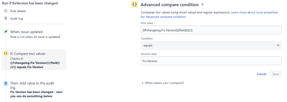

BTW. you can also accomplish it using Jira Automation. In matter of fact using the same method:

Regarding script conditions, in Jira Cloud as far as I believe, you need to provide Jira expression: https://developer.atlassian.com/cloud/jira/platform/jira-expressions which has limited capabilities and is much harder to work with than regular groovy statements. You can nevertheless use it. In your case it would be:
issue.changelogs[0].items.filter(changeLogItem => changeLogItem.field == 'Fix Version').length > 0
and then of course in the Code section your main script.
