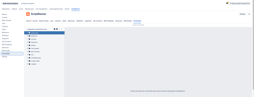

Could you please share a screenshot of your Script Editor, i.e. like:-
I am asking for this to understand how your packages are displayed.
Generally, the Groovy code files and packages should be added to the scripts/ folder, but I did not see it in your description.

Thank you for pointing out the need to put the Groovy scripts into the scripts folder. I copied the scripts into there and changed the path in the script field under the Console to just the script name. It run without warning, and it actually offered to autocomplete the script name. Not only that, but now the script editor seems to be working. Huzzah!
