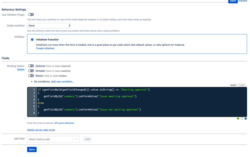

Deleted user October 23, 2019
Hi @Dong Park
Problem here is (I think) that you are trying to get the stored value for the custom field, even though that's not yet passed to the database.
If you want to have your summary being filled in based on a value selected during the edit of the issue, you'll need to add a "server side script" to your field.
I created the following example: I have a select list called "Pending reason". The following script should be added as a server side script to that field to make sure that every time the field's value is changed, the summary is updated.
if (getFieldById(getFieldChanged()).value.toString() == "Awaiting approval")
getFieldById("summary").setFormValue("Issue awaiting approval")
else
getFieldById("summary").setFormValue("Issue not waiting approval")
Hope this helps!
Kind regards
Jorden

Dong Park
October 28, 2019
This method works.
Here is my code to make it work for my drop down selection.
def fromField = getFieldById(getFieldChanged())
def summaryField = getFieldById("summary")
def from = fromField.getValue()
summaryField.setFormValue(from)
Like Deleted user likes this
