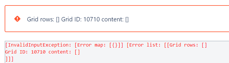

However, I'm encountering a problem with reading the table grid. I'm getting the correct issue and custom field id but it's returning an empty data. So since my validator can't read the grid data, it's not checking anything.
Do you know what might be the issue?

def rows = tgeGridDataManager.readGridData(issue.getId(), tgeCustomFieldId, null, null, 0, 10, user);
def values = rows.getValues()
StringBuilder returnResult = new StringBuilder();
returnResult.append("Grid rows: " + values + "\n");
if (!values.isEmpty()) {
returnResult.append("Grid content: " + values + "\n");
} else {
String msg = returnResult.append("Grid ID: " + tgeCustomFieldId + " content: " + values + "\n");
invalidInputException = new InvalidInputException(msg)
throw invalidInputException;
