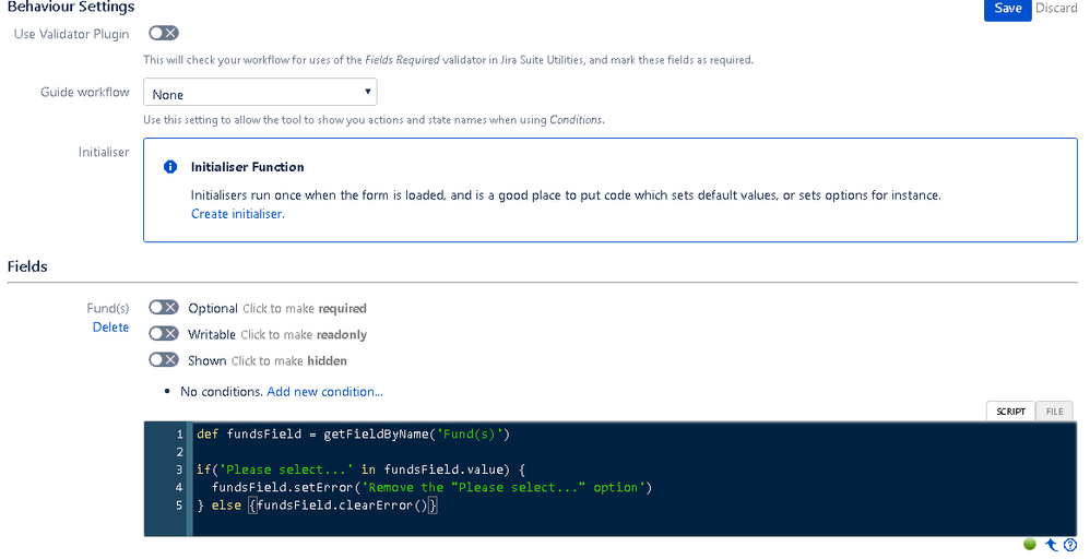

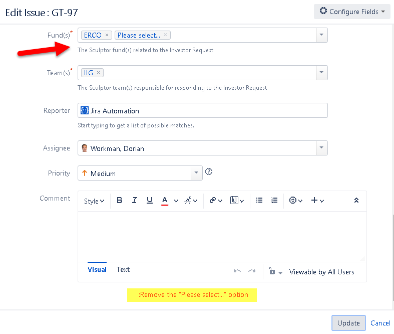

Please see attached screenshots. For some reason the error message generated by the Behaviour on the Fund(s) field is not displayed with that field, but at the bottom of the Edit dialog. Any suggestions how to get it to display right below the Fund(s) field please?
Also, for some reasons a leading colon (:) is being inserted at the beginning of the error message, any ideas why?

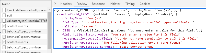

I would suggest also examining the api calls from your browser development panel.
Look at the response from GET: validators.json
Then look at the payload and response from POST: runvalidator.json
You might be able to find some clues there.
Thanks @PD Sheehan, please see screenshots below. I've never looked at the dev console before so please forgive me if I'm asking basic questions. The first screenshot appears to show the validators that were loaded for the field when the edit screen first loaded. The second I think shows what happened when I entered the bad value in the field. Does this offer any clues? If there some sort of a conflict between the Behaviour response and the I18N response (whatever that is)?
I see nothing abnormal there.
More importantly, it's clear that the helptext doesn't include the (:).
The only other thing I can think of is to check your "configure field" option on the screen and make sure you have ShowFields = All. I've seen behavior misbehaving (ha!) when custom field selections have been made.
If that's the case and this fix your issue, I'd recommend you report it to Adaptavist Support.
OMG that was it! Eureka! You're a genius @PD Sheehan!
Do you know if all users would need to set their "configure field" option like this individually, or this is a one-time admin setting?
Unfortunately, that's every user.
It used to be that those validation errors would go completely unnoticed and behaviour was unable to prevent submitting the form if errors were present on hidden fields.
So perhaps they've made some inroads into fixing that, but that causes the message to not be placed against the correct field.
Your field has got brackets in its name, which are special characters. Without having tested it, I'd suggest to get the field by ID instead of getting it by name, try:
def fundsField = getFieldById("customfield_nnnn")replace nnnn with the id of your custom field

Thank you @Leonard Chew and @PD Sheehan for your suggestions, but unfortunately no luck.
I tried getFieldByID, exact same result. I also tried renaming the field to remove the parenthesis, also no luck.
I don't have any other Behavious on that field either.
As you noted @PD Sheehan, 'Please select..." is a defined option in that multi-select list (it's the default option, so that the field is always displayed on the View screen).
Any other thoughts?
