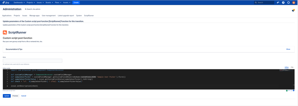

Below is the sample code that I have tested with:
def customFieldManager = ComponentAccessor.customFieldManager
def sampleUserPicker = customFieldManager.getCustomFieldObjectsByName('Sample User Picker').first()
def sampleUserPickerValue = issue.getCustomFieldValue(sampleUserPicker).toString()
def check = "cf: ${sampleUserPicker} / cfVal: ${sampleUserPickerValue}"
issue.setDescription(check)
Please note that the sample code above is not 100% exact to your environment. Hence, you will need to make the required modifications.

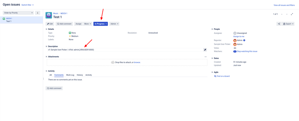

Below is a screenshot of the Post-Function configuration:-

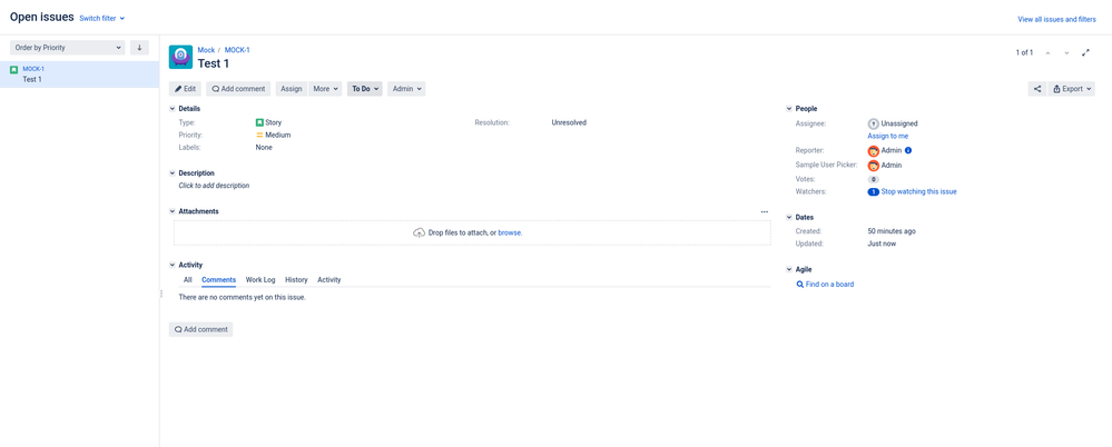

Below are a couple of test screenshots:-
1. First, the Description field is set to blank when the Issue is created. Also, you will notice that a Custom Field called Sample User Picker is filled with the Admin user.
2. Once the Issue transitions to the In Progress status, the Description field is updated with the values set in the code.
Regarding why you are getting the Null value, I suspect the value for the User Picker field has not been set yet. (I could be wrong)
