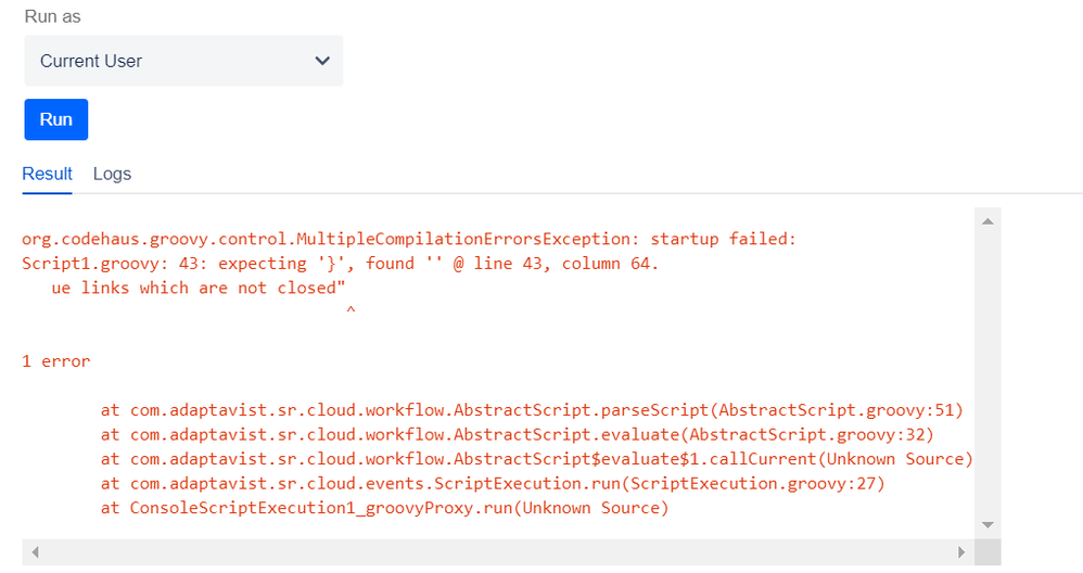

Hi @Kristian Walker _Adaptavist_ , / @Adam Dulberg ,
I am on cloud JIRA
I am trying to achieve the same what you discussed above, I have used your code but i am getting error. please have a look my attached screen short .
def issueKey = "<ETM-495>"
// Specify the name of the version to extract from the issue
def closedStatus = '<Cancelled>'
// Specify the transition to execute on the issue
// NOTE - The transition ID must represent a valid transition for the workflow that the issue uses.
def transitionID = '<11>'
// Specify a boolean to flag if all issue links are resolved
boolean allIssueLinksResolved;
// Get the issue object
def result = get('/rest/api/2/issue/' + issueKey)
.header('Content-Type', 'application/json')
.asObject(Map)
// Find the linked issues
def linkedIssues = result.body.fields.issuelinks
// if all issue links have the Done status set the flag to true
if(linkedIssues.findAll{closedStatus.contains(it.outwardIssue.fields.status.name)}){
allIssueLinksResolved = true
// If any of the linked issues do not have the done status set the flag to false
if (linkedIssues.findAll{!closedStatus.contains(it.outwardIssue.fields.status.name)}){
allIssueLinksResolved = false
// If all issue links are resolved transition the issue
if(allIssueLinksResolved == true){
// The rest call to transition the issue
def transitionIssue = post("/rest/api/2/issue/${issueKey}/transitions")
.header("Content-Type", "application/json")
.body([transition: [id: transitionID]])
.asObject(Map)
return "All issue links are to closed issues and the issue has been transitioned."
// If the issue contains unresolved linked issues return a message and do not transition the issue
}else if (allIssueLinksResolved == false){
return "The issue contain issue links which are not closed"

Hi @Musku Nagaraju,
have a look at the error message again. It quite clearly expresses what the problem is: a missing curly brace '{'.
If you copied your whole script into here, you should add a curly brace at the end of your script.
Cheers,
Matthias.

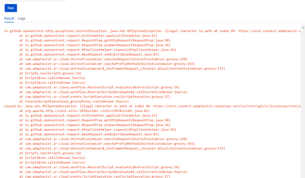

I have put curly brace, their is no error now but the workflow sync not working.
I have used this code in post function "run script"

Hi @Musku Nagaraju,
please have a closer look at the error message again - it tells you more information about the problem: Illegal character in path at index 89.
If you want to use a solution like Scriptrunner, I highly suggest to read error message, try to understand them and see if you can solve the problem.
If you don't feel equipped well enough for that, you can always look for other apps where you don't need to code or look for an Atlassian solution partner which will help you in the configuration.

Hi Musku,
Thank you for your comment.
I have reviewed your script above and notice that in the issueKey,transitionID, and closedStatus variables that you are have defined your values inside of < and > tags and these tags should be removed as you just need to define your values as plain text inside of the speech marks for the variables.
In the example script, the < > tags are just to show where you need to update the script and to specify values as a string and should be removed.
Also please note when reusing the sample script you must keep the block comment from the top of the script as the licensing comment which is required to reuse the script sample provided.

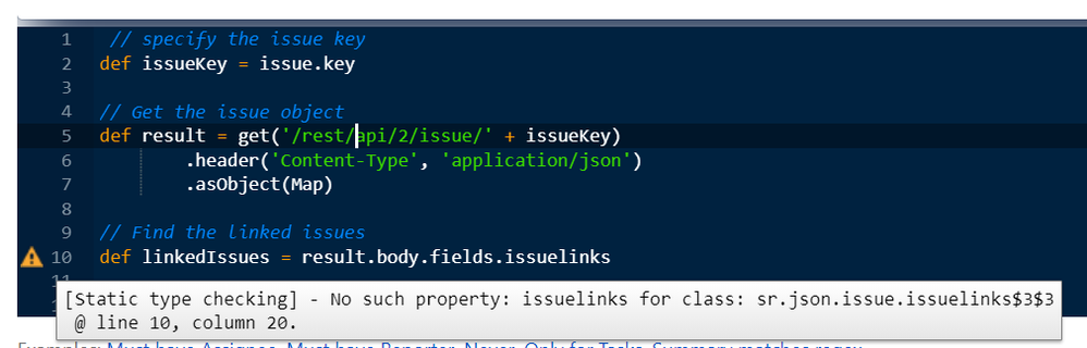

Hi @Kristian Walker _Adaptavist_ I am reviewing the script you provided above and line below has a warning. I am using JIRA Cloud. The reason for the interest in your script is because I would like transition an issue to status if when it is created it is a bug and has a link to an issues that is currently in development.
Hopefully you can help shed some light.
October 26, 2020
Hi Jeff,
Thank you for your response.
I can confirm that the yellow warning you are seeing is just a static type checking warning as described here and these warnings are just where the compiler does not fully understand the code and these are not errors that will stop the code from running.
This means that the code will likely still run and I would advise you to test running the code as I have it defined in my example in the Script Console in order to see if it works as expected.
If you are using the code elsewhere such as in a post function then you will need to log out the issue object to see what structure is used to store the field values in this object in order to check how to access the issue links field as my example is only designed to work on the script console where the issue is fetched by a call to the Get Issue API.
I hope this information helps.
