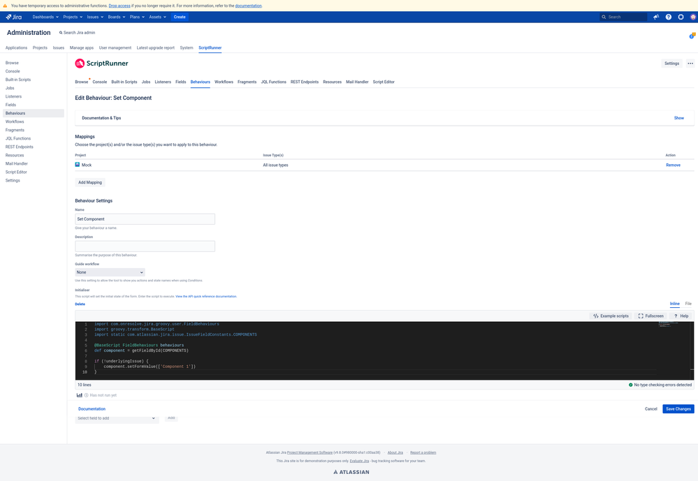

For your requirement, I suggest you try something like this:-
import com.onresolve.jira.groovy.user.FieldBehaviours
import groovy.transform.BaseScript
import static com.atlassian.jira.issue.IssueFieldConstants.COMPONENTS
@BaseScript FieldBehaviours behaviours
def component = getFieldById(COMPONENTS)
if (!underlyingIssue) {
component.setFormValue(['Component 1'])
Please note that the sample working code above is not 100% exact to your environment. Hence, you will need to make the required modifications.
If you observe, I have used this approach to Initialise the Component/s field:-
Because the Component/s field is a system field, it is best to Initialise it using the Field Id instead of the Field Name as you have done.
Below is a screenshot of the Behaviour Configuration:-
Below is a test screenshot for your reference:-
1. When the Create dialog is opened, by default, the Component/s field is updated, and the option Component 1 is selected as shown in the screenshot below:-
I hope this helps to solve your question. :-)
Thank you and Kind regards,
Ram
