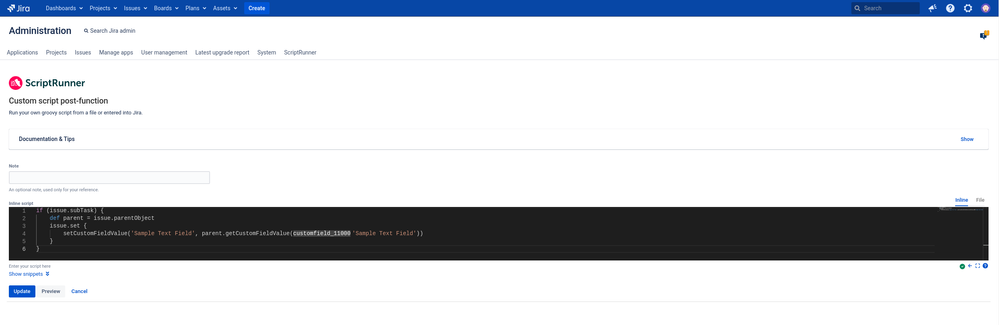

The approach above uses the old ScriptRunner approach. I recommend upgrading your ScriptRunner plugin to the latest release, i.e. 8.7.0 or at least version 7.11.0, so you can use the HAPI feature.
Using the HAPI feature, all you have to do is:-
if (issue.subTask) {
def parent = issue.parentObject
issue.set {
setCustomFieldValue('Sample Text Field', parent.getCustomFieldValue('Sample Text Field'))
Below is a screenshot of the configuration using HAPI:-
I hope this helps to answer your question. :-)

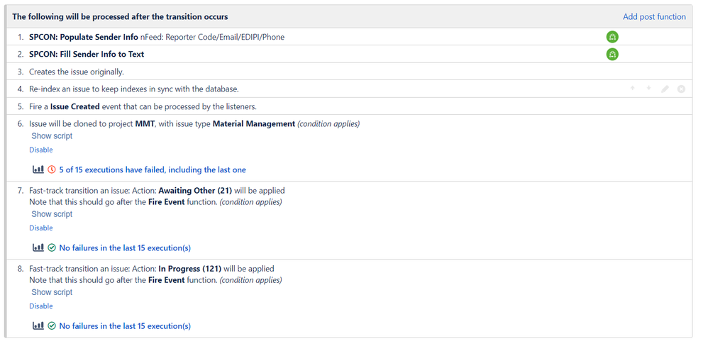

It looks like I do have scriptrunner 8.7.0. Do I have to add the custom script post function in addition to clones issues? Here is my current configuration:
Would I have to add the "HAPI" Script above in addition? Also, the reason I am doing it this way, rather than just using project automation is to be able to grab the custom field value of the "users" custom field.
