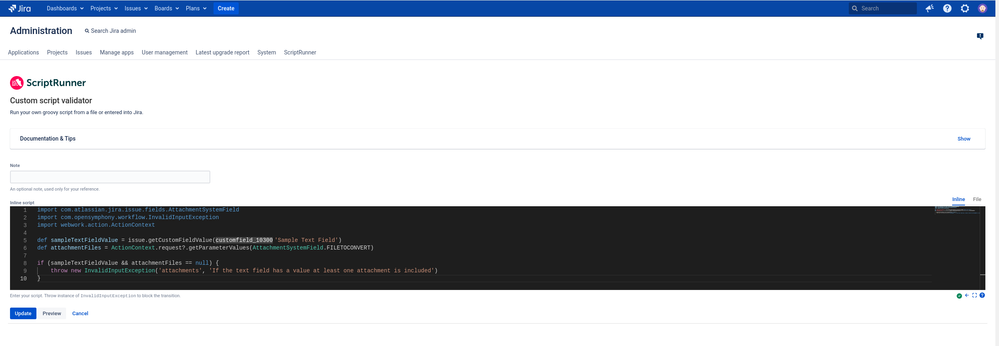

Below are the configuration screenshots for your reference:-
1. Go to the workflow and click on the Create transition. When the dialog appears, click on the Validator link as shown below:-
2. Next, select the Custom Script Validator [ScriptRunner] option as shown in the screenshot below:-
3. Once in the Custom Script Validator, add the sample code above as shown in the screenshot below:-

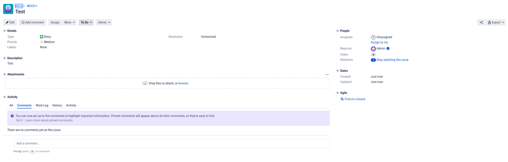

1. For the 1st test, I will create an Issue without any value added to the Sample Text Field, as shown in the screenshot below.
2. The issue is created as expected without any problem.

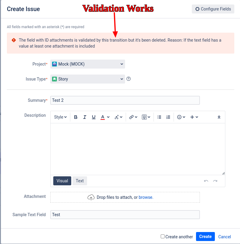

3. For the 2nd test, I am going to create an issue with some value added to the Sample Text Field and will leave the Attachments empty shown in the screenshot below:-
4. When I try to create the issue, as expected, the Validator returns an error message as shown in the screenshot below:-

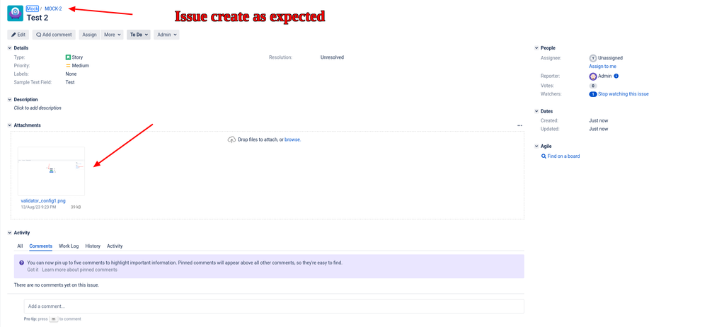

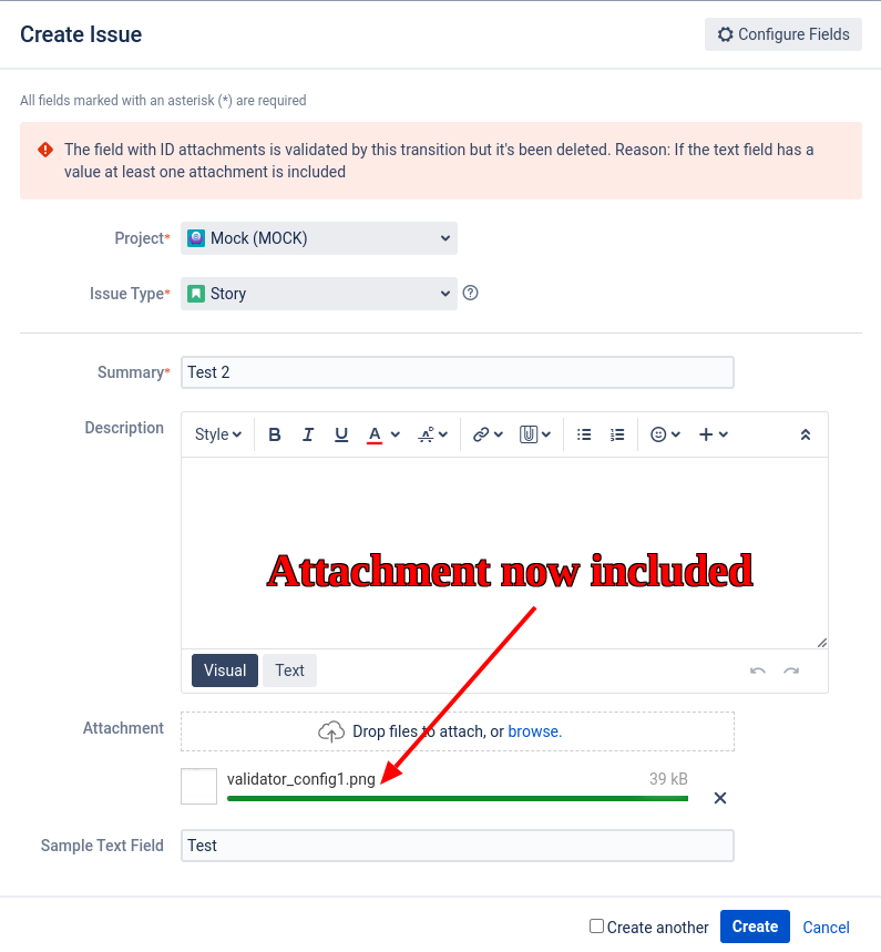

5. Next, I add some attachments and try to create the issue as shown in the screenshot below:-
6. As expected, the issue is created with the value set for the Sample Text Field and the Attachment included as shown in the screenshot below:-
