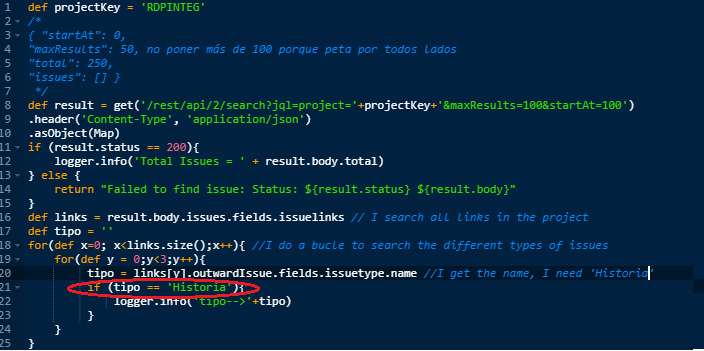

Morning;

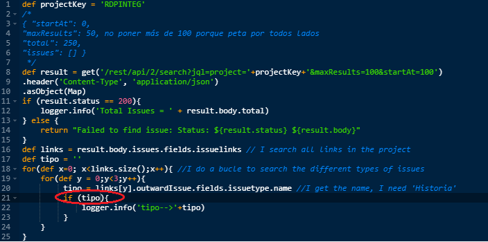

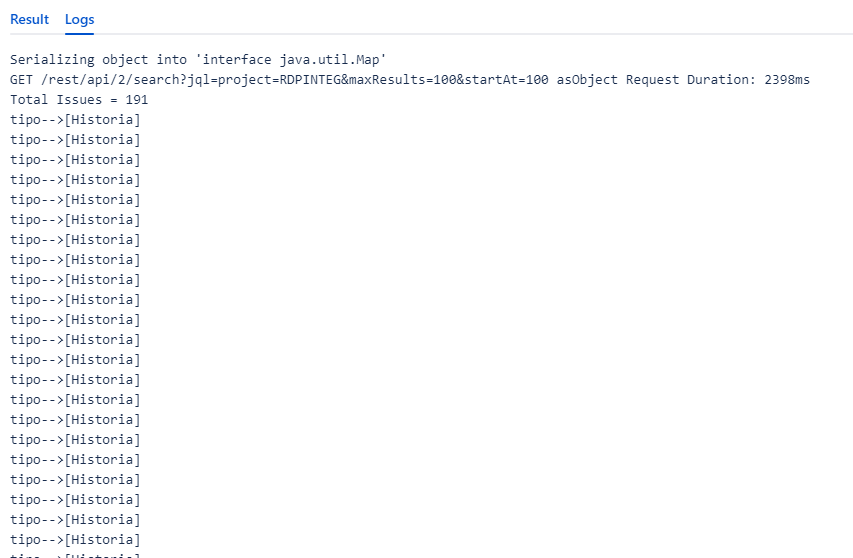

I need need to extract the issue type, and the issue status, and when I put this script, the logger.info nothing extract.
But when I put this other:
The result is :Captura3.PNG
So I don't know why in the first code doesn't work :
if (tipo == 'Historia'){
    logger.info('tipo-->'+tipo)

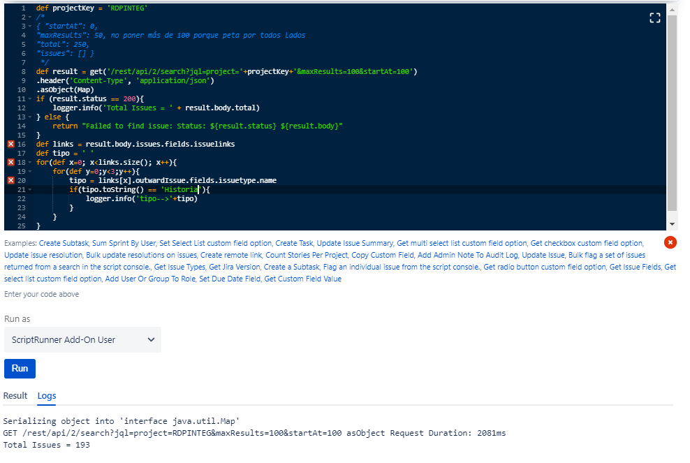

issue type probably returns an "IssueType" instead of string. You can check the type with getClass(). It should work if you convert it to string: tipo.toString().

Eduard Diez
November 22, 2018
Sorry...
I put the getClass() like this:
if (tipo.toString() == 'Historia'){
And the the problem continues...
Thank's

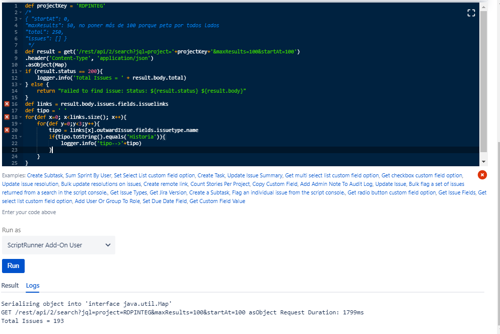

So what does it do when you put it like this, what is the behavior? It returns nothing or returns an error? I can't think of any reason why it shouldn't work like this. Maybe try it with equals like:
 tipo.toString().equals('Historia')

Eduard Diez
November 22, 2018
Whit tipo.toString().equals('Historia'):
