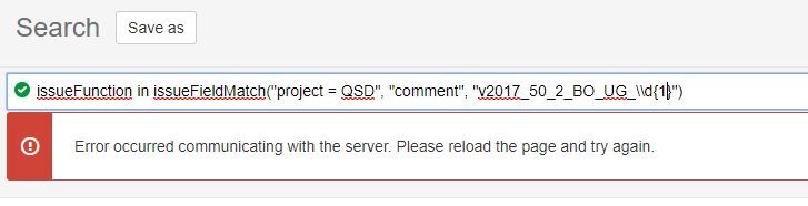

When I try the Scriptrunner option "issueFunction in issueFieldMatch("project = QSD", "comment", "v2017_50_2_BO_UG_\\d{1}")" I get an errormessage "Error occurred communicating with the server. Please reload the page and try again.".Errormessage on scriptrunner search options.JPG

Sorry about that.  I believe I made a mistake here in recommending scriptrunner for your specific user case. It looks like that specific function is intended to look at issue fields in Jira, however the comments on issues are not technically issue fields, hence I don't think that is going to help us here find what you are looking for.
