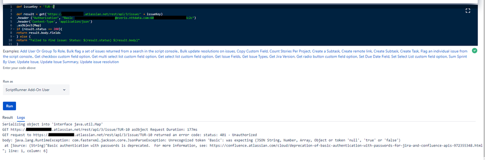

Hi @Andy Heinzer
I try put my user and my token and it not woks, I send a photo if you can help me. Thank's
Andy Heinzer
May 12, 2021
Yes.  You cannot just pass the email:token. Instead you need to base64 encode that string first and pass that instead.  For example if your email address was fred@example.com and your token was freds_api_token you would have a string of
fred@example.com:freds_api_token
On a linux/unix/mac you can use a command of
echo -n fred@example.com:freds_api_token | base64
The output of which would be
ZnJlZEBleGFtcGxlLmNvbTpmcmVkc19hcGlfdG9rZW4=
You need to pass that string in the authorization header so that in this case it would look something like:
.header ("Authorization", "Basic ZnJlZEBleGFtcGxlLmNvbTpmcmVkc19hcGlfdG9rZW4=")
If you are using a Windows machine, you can also find instructions on how to encode this string over in Basic Auth for REST APIs.  Try that and let me know the results.
