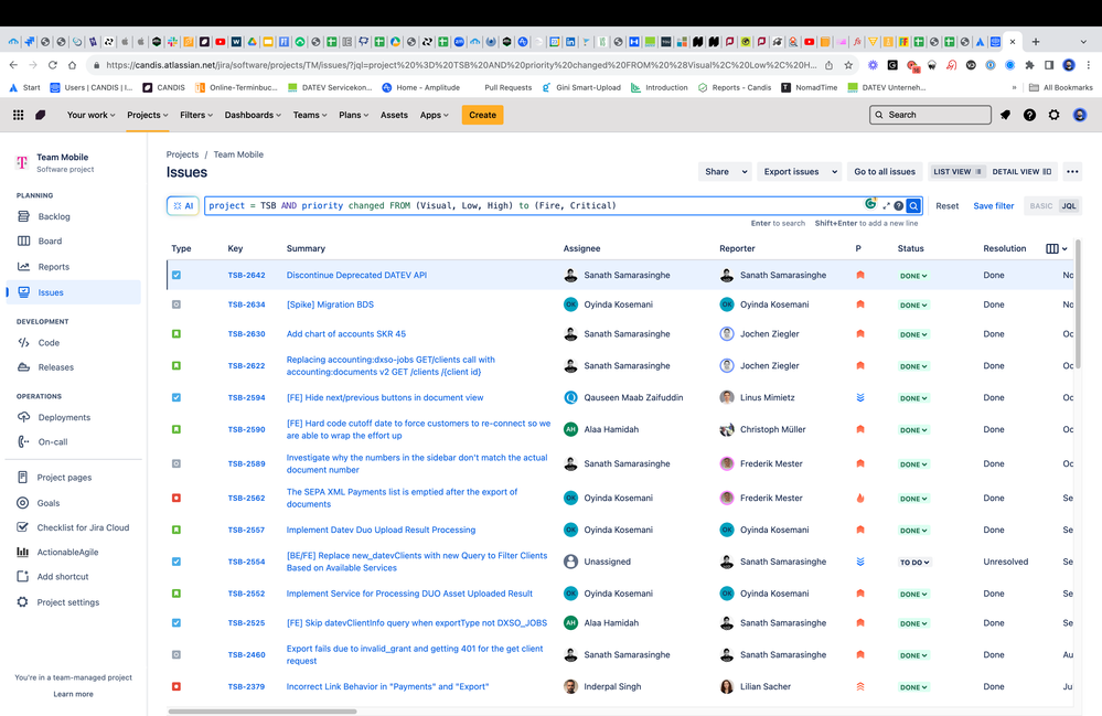

@Trudy Claspill alright, I just tried the part of the JQL query that doesn't work. And here, for example, the query surfaces issues with priority 'Low' which shouldn't happen.
That portion of the query doesn't include a criteria to check that the current priority of the issue is Critical or Fire. It is retrieving issues that have changed priority as you specified, but that change could have happened at any time. It is not necessarily the last change that happen. After being changed as you specified the issue could've been changed again to a different priority.
