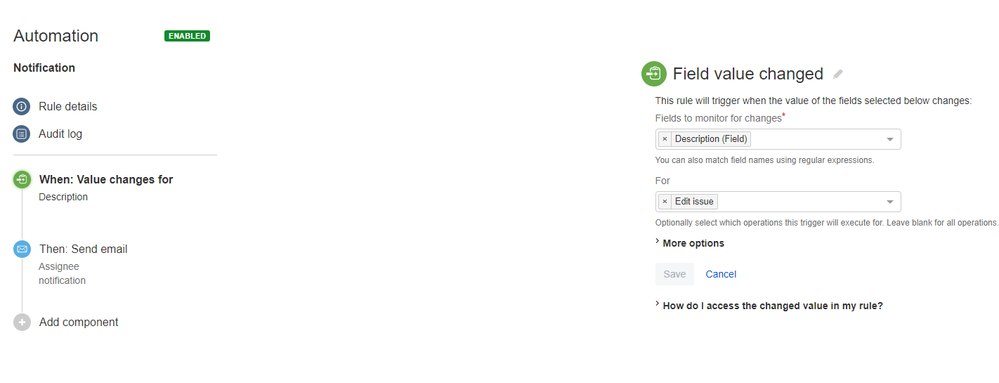

For this kind of task I would strongly recommend the Automation for Jira plugin. For your problem, I created your notification on field update in two simple steps as you can see below:
This will make your solution completly automatic, otherwise I am afraid you have to stick with your manual solution. I hope that this solves your issue!
