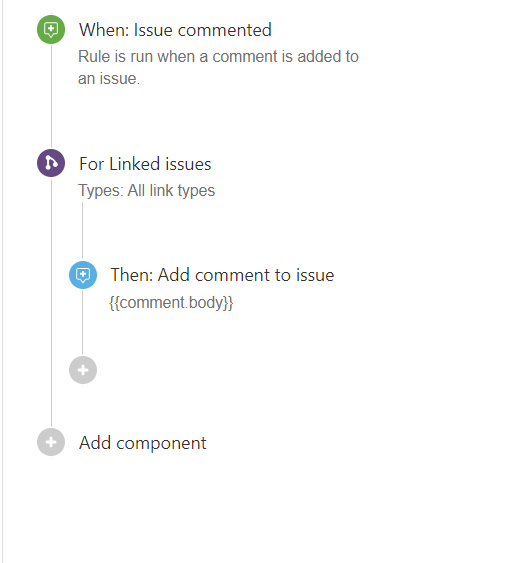

I need to send new comments from a ticket, to the cloned one
For example: I have ticket A, and I make a clone of that ticket, now I have ticket B
Right now if I comment the ticket A, that comment is not going to show in ticket B
I want to know if there is a way to send that new comment from the ticket A to the cloned ticket B WHITOUT using exalate, right now im using a script runner post function to clone the tickets.

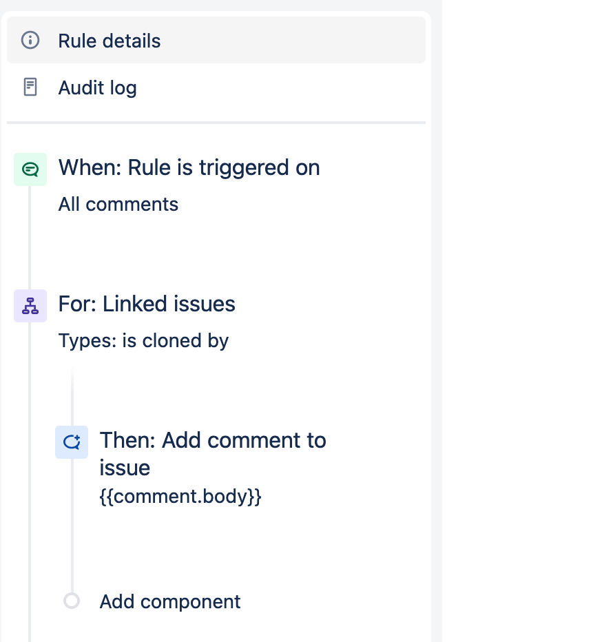

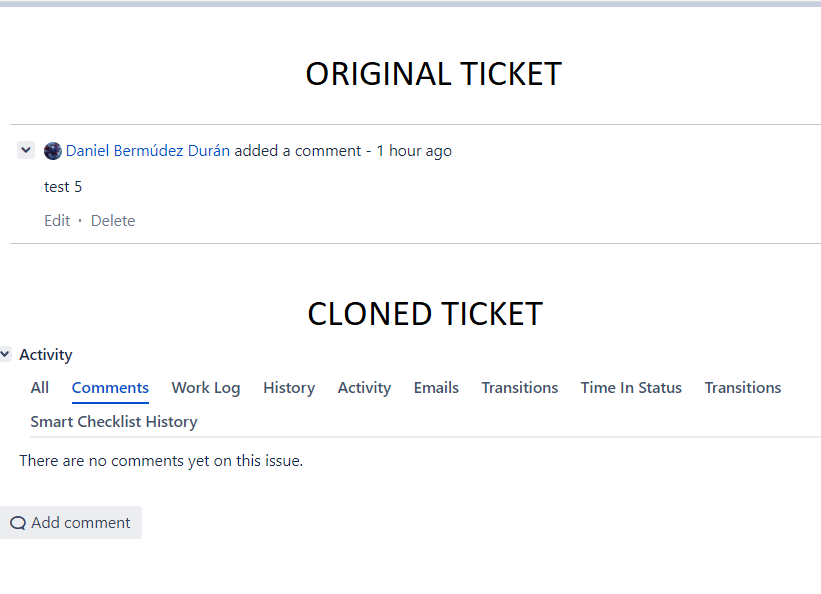

Hello! I tried exactly this automation but idk why it didnt worked...

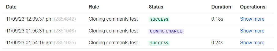

In the audit log it says that the automation was succesful but in the cloned ticket the comment does not appear.
No, this comunication is between 2 different projects
You would need to make sure your rule is configured to run in both projects then.
