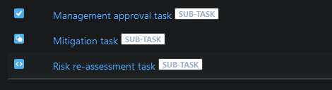

@Bill Sheboy ok, that make sense, however I have couple of "custom" types of sub-tasks. So it should be there at least one sub-task from type of "Mitigation task". How can I take this condition into account?
Bill Sheboy
August 8, 2022
In that case, I recommend using JQL to find the subtasks of the types you want to count, and with the same parent of your trigger issue, storing the results with a Lookup Issues action.  Then you can still use the size function to count how many are found.

@Bill Sheboymy JQL didn't work. But I have issue type "Mitigation task" as well. subtask type.PNG

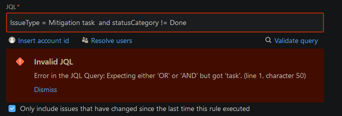

And here is my JQL query:

Lukas
August 9, 2022
Ok, I found it out, i have to use "" like, IssueType="Mitigation task". But still I couldn't figure it out, how I can use size function in this case.
Bill Sheboy
August 9, 2022
Your JQL could be something like this in the rule:
project = myProjectName AND parent = {{triggerIssue.key}} AND issueType = "Mitigation task" AND statusCategory != Done
Try using that with the Lookup Issues action to return the issues.  Then check the size of the results:
{{lookupIssues.size|0}}
