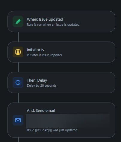

I'm trying to create an email notification that will get sent to my team when the reporter makes changes to their issue. It's working except it's sending an email for every field that gets changed... I really just want one email saying changes have been made. I tried putting in a delay but no dice. It just delays both emails by 20 seconds!
Hello @Tschilar, Stacey
The rule will be triggered by each update to the issue. Each field that gets changed is a separate update.
What problem are you trying to solve by creating this automation rule?
Is it not sufficient to rely on the Notifications configuration for the project to send notifications to interested parties when the issue is updated?
The issue is created via a front door process, where the reporter is the person filling out the form. We want the team to know if the reporter, specifically, has changed anything about their issue since they submitted it. Right now changes are happening without the team working the issue being notified, and we don't necessarily want all notifications turned on for any person working it. If that makes sense!
