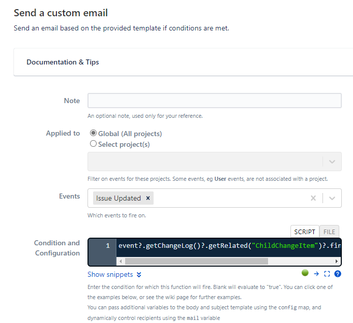

Hello @tejraj_123 ,
If you are using ScriptRunner, in addition to what Craig said, you could also use the "send a custom email" Listener, on the "Issue Updated" event, with this condition :
event?.getChangeLog()?.getRelated("ChildChangeItem")?.find {it.field == "duedate"}
You will be able to configure projects, mail content and address etc. in the UI :
Hi @Antoine Berry ,
I'm new to the Scriprunner, Can you please post the Script here. my requirement is If any change in 'Due Date' field in 'XXXX' Project , a notification should be sent to XXXX person.
Tej.
Hello @tejraj_123 ,
If you try to create a listener, select "Send a custom email", you will be able to configure it. If you check my screenshot above, you can see that you can select the project.
The snippet should evaluate to true if the due date is changed, on the "Issue Updated" event (i.e. edit mode - you can add more events).
Then it is up to you to customize the mail template, the addresses...
Please check the documentation for more information. :)
