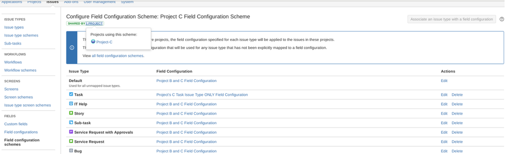

Hi Dominik,
you have to create a seperate Field Configuration and a seperate Field Configuration Scheme for Project C.
Now, the field "description" should be invisible for tasks.

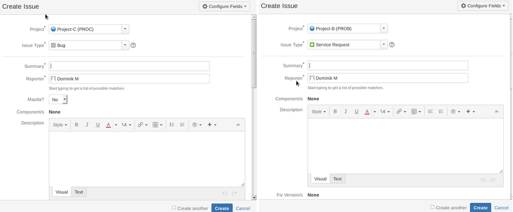

to make it fully done:
accessed project C, used GP shortcut
I've associated:
--> create issue screen with PROB: Scrum Default Issue Screen (Description Field must be ABSENT HERE)
--> edit issue with Copy of PROB: Scrum Default Issue Screen (Description Field must be PRESENT HERE)
-->View Issue with Copy of PROB: Scrum Default Issue Screen (Description Field must be PRESENT HERE)

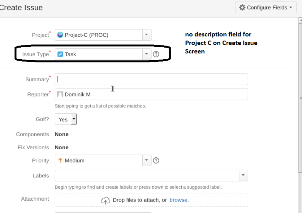

by doing so I have "Description" field removed from the "create issue" screen and present when editing and viewing the issue.

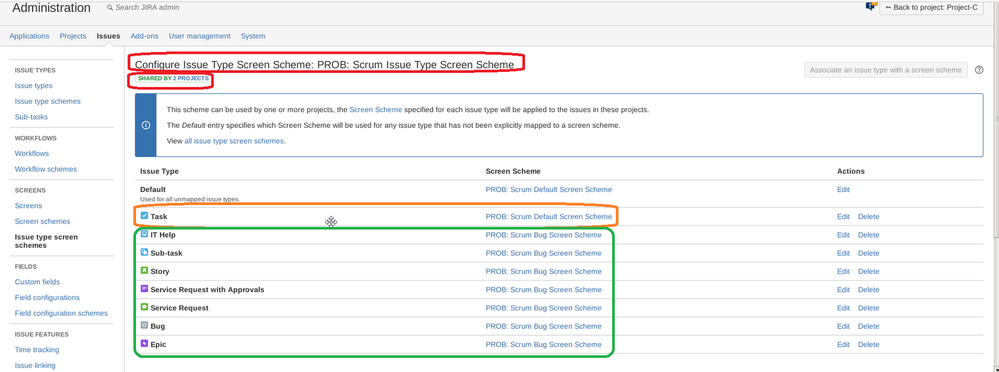

Unfortunately it affects all issue types (and I need it only on task issue type). I've noticed that "Bug" issue type isn't affected by this and it works as the "Task" issue type as it uses its own "Bug Only Issue Type Scheme":

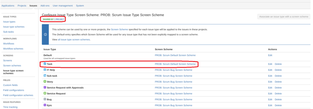

so far, so good except the fact that issue type screen schemes are shared for 2 projects.
what needs to be done here is now FIRST to differentiate project's B screen schemes from project C and then amend them.
I've copied PROB: Scrum Issue Type Screen Scheme and saved it as PROC: Scrum Issue Type Screen Scheme, then it was associated with Project-C
now it's time to do amendments only for Project-B Task Issue Type:

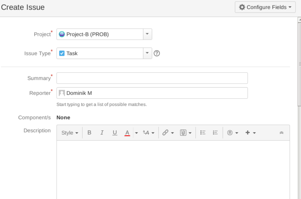

and testing phase time!:
above everywthing nice and smooth as it should be
Project-B:
edit screen/view screen tests were done as well and description field is present for task issue type in Project's-C only on create issue screen.
