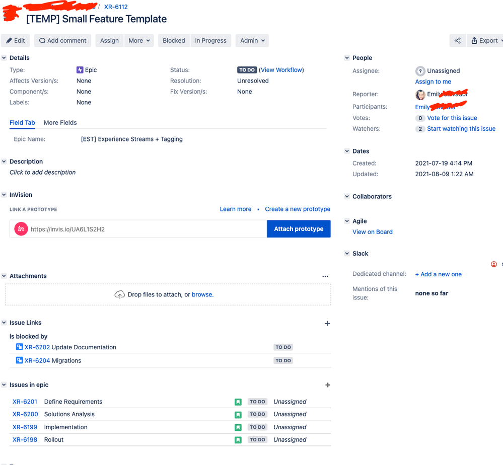

So far, I have four 'create/clone issue(s)' post-functions set for the Epic workflow in a project to automatically create and nest four different types of issues under the triggering epic:

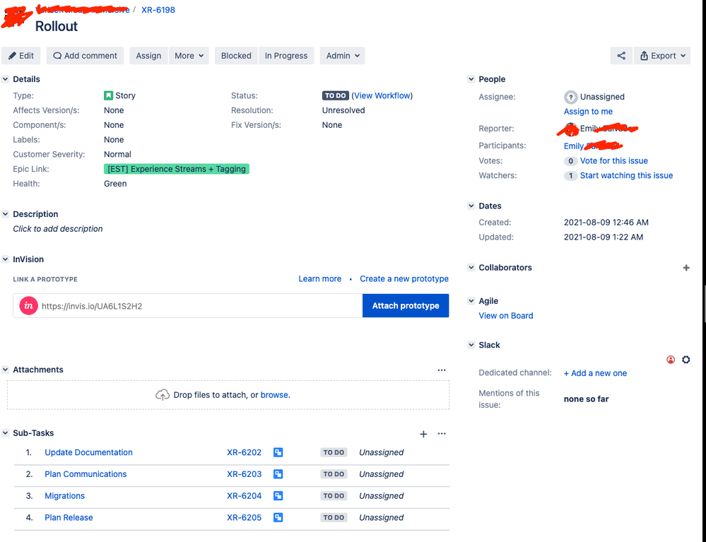

Each of the Issues in epic (Define Requirements, Solutions Analysis, Implementation, and Rollout) have their own set of sub-tasks which are also auto-generated via post-functions set in workflows unique to each issue type. For example, Rollout:

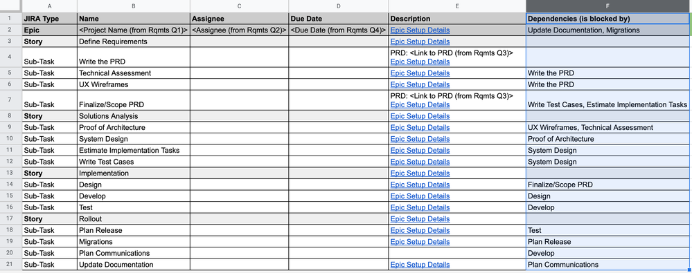

Almost all the issues created have linked issue dependencies:

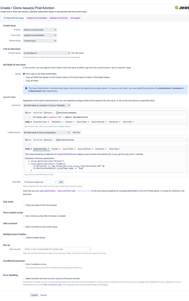

This is where I'm stuck. I'm not exactly sure how to set the 'Linked Issues' field to direct to issues that aren't directly involved in the automation. For instance, I have a 'Create / Clone Issue(s) Post-function' set in the create transition for the Rollout workflow that's responsible for creating the Update Documentation Sub-task nested under Rollout:
In Groovy, what expression would work to set a "blocks" link to the parent issue's epic, as well as a "is blocked by" link to a separate sub-task nested in the parent issue called Plan Communications?

So I tried using that snippet for my use case to link the Update Documentation sub-task that's being created here to the most recently created Plan Communications sub-task (both of which are nested under the same Rollout parent issue) indicating that the Update Documentation sub-task "is blocked by" the Plan Communications sub-task. I added this as a post-creation script in the 'Create / Clone Issue(s)' post-function that creates the Update Documentation sub-task:
