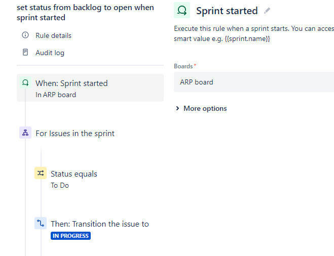

When a sprint is started , every issue inside it is set from "BAcklog to "open"
When an issue is set to an active sprint , Its updated from backlog to open

1 when a sprint is started, every issue inside is set from backlog to open
2. when an issue is set to active sprint,updated from backlog to open
For this I have created the rules and which are working fine.(Attached rules above)
Now I would like to make it as a global rule, which is not possible because we do not have option to select multiple boards.
 the rule is also including events when the issue is moving from one sprint to another or from one sprint to the backlog
Set  an active sprint from "Backlog "to open
1. The start sprint filter is considering boards in "XYZ" project ONLY. it should be generic capturing any sprint under any project or board.
2. The project filter should be only in the "SCOPE" of the rule.  But right now I am also using the project "XYZ" in one of the components of the rule.
this should be removed.
Is it possible to use JQL? what should be the trigger?

Arnav April 22, 2022
Hi  Bill,
Arnav May 12, 2022
Hi Bill,
As per  your previous suggestion I have gone through document,
"Set status from backlog to open " As per my understanding The automation rule vary through Workflow.
The above mentioned diagram ,For that workflow is (Todo, inprogress,Done)
Now I would like to create for one more project ,Workflow is ( backlog,open ,inprogress,close)
I have changed the rule by replacing status ,Which is not working.
Please find the image and suggest neStatus.PNG cessary changes

Just to confirm did you recreate the rule in the other project, or change the rule to be global/multi-project in scope?
That is important if one of the projects is team-managed, as they have separate instances of status values for each project...even though they may have the same status names.

This is the structure for an Automation rule for transitioning the status of all issues in a sprint when the sprint is started:
This rule from Jira's automation library will give you a starting point for creating an Automation Rule to change the status of an issue when it is added to an active sprint:

Hi Trudy,
Thank you so much your response.
My rule is working fine . I have mentioned the screenshot above.
