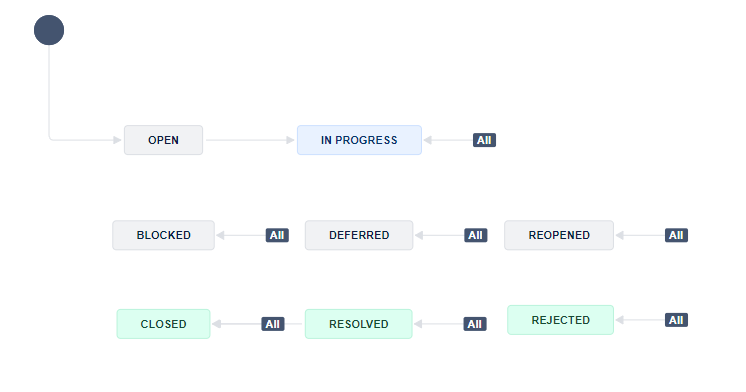

Hi, Im working with a workflow that contains multiple green statuses and all transitions. Currently with no resolution set nor cleared. Started up with setting resolution to
Closed | Resolution is done | |
Resolved | Resolution is fixed | |
Rejected | Resolution is Wont do |
Issue is that when going from Rejected to Closed, resolution wont do doesn't change to done. Do I need to add another post function to clear resolution?

Wow, there is a lot going on there. Yes, you can add a post function to clear the resolution and put that as the first step. Then add another post function to set the resolution and have it lower down in the steps. But the problem is that there is no guarantee that Jira will execute the steps in that order.
I think you would be better off having a single Done status with a transition screen with the Resolution field on the screen where the user sets the Resolution when it is moved to Done.
If you don't trust your users, you could a self looping transition to the Done status with a condition that only the Jira Administrators group could execute that would clear the resolution. Then other one with the same condition that would include the transition screen so you could set it to the right one.

What If I merely copy the workflow, edit the inactive copy by removing the three green, adding the new green done incl resolution screen. Back to the project with scheme and associate with adjusted workflow to the affected issue type. Here I assume there will be a migration path where I need to take some mapping decisions..? and then follow through?
Could this be a way do you think?
Here would be my suggestion.
$0.02 on Resolved: if your workflow is such that issues often transition to resolved prior to going to closed then I would keep the resolved status separate. I would not set the resolution on resolved, unless it was a terminal status like Done.
Yes, Jack's suggestion is the route to go because you need to get the Resolutions all set in the single status before removing the other ones. The migration process probably won't allow you to set the Resolution field at the same time.

Yes you would need to set when entering any of the three done category statuses and you would need to add a clear field for each "all" transition into each of the other (non-done) statuses except Open. As an aside, you might consider eliminating the rejected status and using the Resolution field to indicate rejected.
Hi John, thanks for swift response! Question If I choose to set up one single Done status and apply a resolution screen, covering Rejected, wont do etc. What happens when I remove the existing green statuses Closed, Resolved and Rejected? Is there a need of applying some sort of mapping up front so I dont affect tickets irrespectively where they are in the WF?
