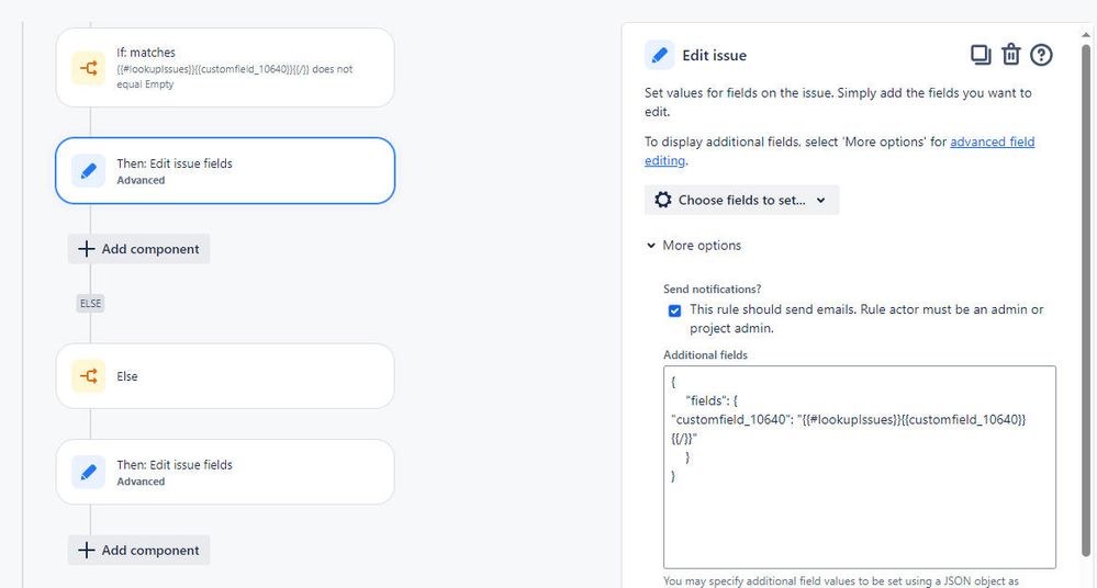

I'm trying to use advanced editing automation and trying to set Data type custom field with some value from a lookup Issue OR null, but I can't figure why it does not work.
{ "fields": { "customfield_10640": null } }
This one works fine, it will clear the data custom field.
{ "fields": { "customfield_10640": "{{#lookupIssues}}{{customfield_10640}}{{/}}" } }
This also works fine, when the lookup issue filed is filled with some data it works. BUT when the look up issue is empty, it fails.
{ "fields": { "customfield_10640": "{{#lookupIssues}}{{customfield_10640|null}}{{/}}" } }
This does not work.
Tried all kind of tricks to go around but just can't figure why does not work.

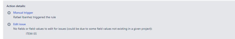

For a question like this, context is important for the community to help. Please post an image of the complete rule and audit log details showing the rule execution.
Until we see those...
You appear to be using the Lookup Issues action (which returns zero-to-many issues) and setting the value into the same field for a single issue. What is the type of the field, as I would not expect that to work except for a text field?

Hello Bill.
The automation I'm trying to do is exactly what I posted below. I want to set a data type field same as the one found in the lookup issue. I made sure only one is returned (used the lookupIssues.size.
That is exactly my issue. conditional logic does not work in the advanced field edit.
The test below did not work, Does not matter what I put on the Summary, the line is always skipped.
"fields": {
{{#if(equals(issue.Summary, "TEST"))}}"customfield_10640":null{{/}}Here is the message LOG
The only conditional that seems somewhat works, its the "exists"
"fields": {
{{#if(exists(lookupIssues.customfield_10640)}}"customfield_10640":null{{/}}Problem is that it always returns true, either custom field in the lookup is empty or not so its not helpful in this case.
