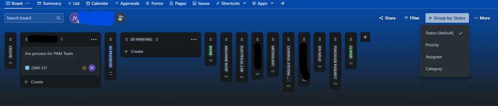

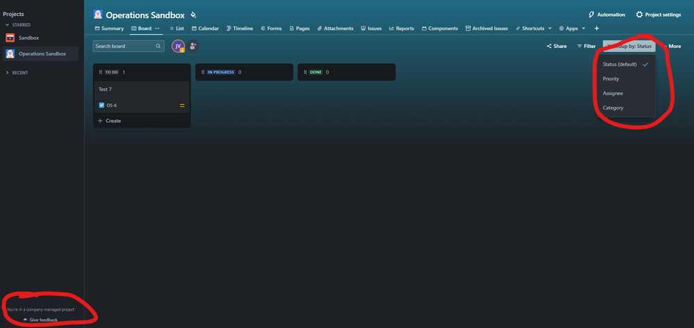

Thank you for your response. I was awaiting access to a CM-work management sandbox.  I have played with it for a few days now, and here are answers to your questions and my thoughts. The new project was going to be a buffer between the company and the 2 teams, but we have decided to stick with one large project that has, for lack of a better term, buckets that issues will fall into for each process/work ( 3d printing, fabrication, CNC, etc). CM has a lot more functionality than TM projects.

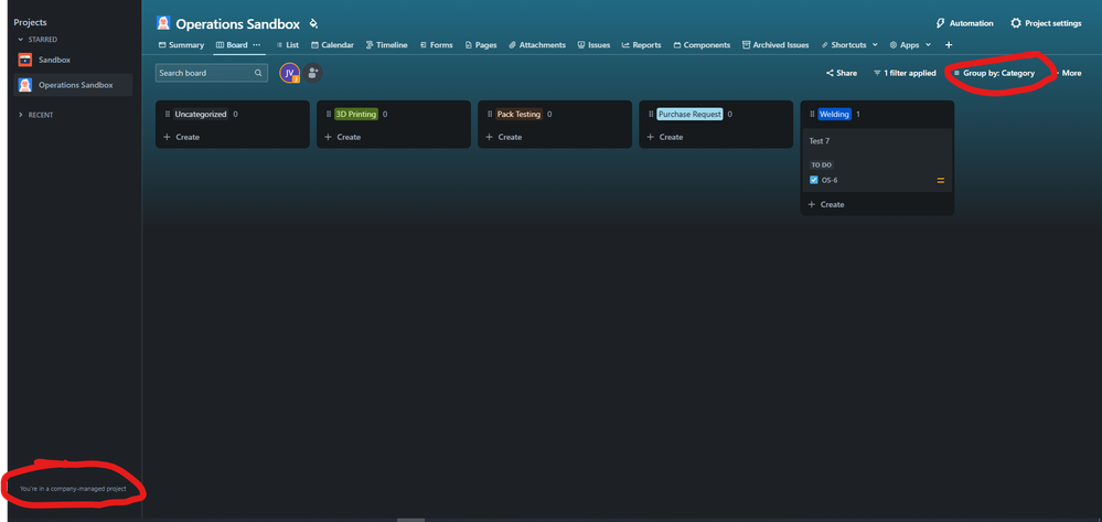

That said, I started organizing the tasks using components/categories instead of statuses. Does this make sense?
I like components because they are very easy to use, and I can automate them. Categories are not as easy to use and can be grouped by categories ( components lack this capability).
This is an existing TM project and in a board view.
The next 2 are CM projects with status and category in a board view, respectively.
Based on this, can you point me in the right direction? I am at an impasse about which direction to take. Whatever we choose must be simple and practical for our technicians, who avoid technology as much as they can.
