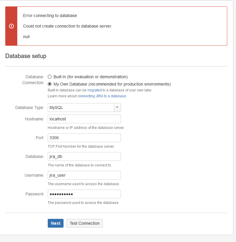

I have followed the tutorial https://linoxide.com/tools/install-jira-on-ubuntu-linux/ but at the stap 4 I cannot connect to my Database (Error null - see Picture below).

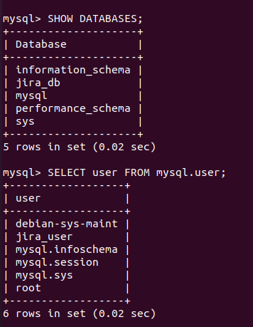

The Database jira_db, as well as the user jira_user exists in the Database.
Where can the error lie? And what is the Error (null)?
I suggest you to check atlassian-jira.log file in {jira_home}/log folder. You can post it here and I can check it.

The log I saw there is from a Jira that has gone way past the installation . So I am a bit list on where the problem is.
Maybe some compatibility issues? In supported platforms document for your version (https://confluence.atlassian.com/adminjiraserver078/supported-platforms-947188411.html), there is a note for MySQL to use this driver - https://dev.mysql.com/downloads/connector/j/5.1.html.
BTW, why are you installing old version of Jira (7.8.2)? I suggest you to install at least 8.10.
