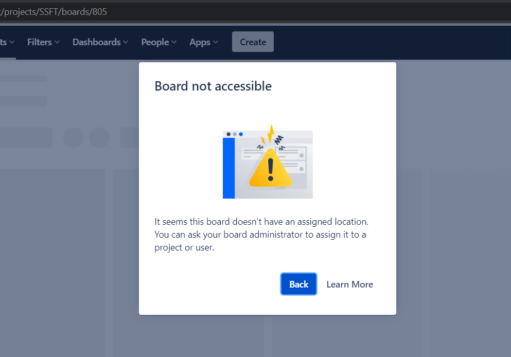

hello
I sent her direct link and error
John Funk
October 25, 2021
Ah - you need to make sure the board has a location for it under Board Settings > General
The make sure the group has Browse project permissions for the project in the Location field.

Users in the group have to have Browse Project permissions for the project in the Location field for the board in order for the board to work. That is probably why there is the error.
